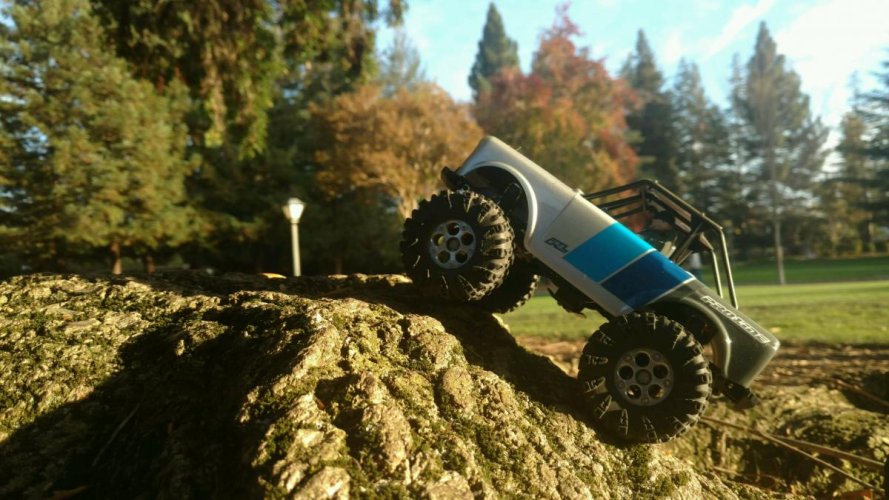

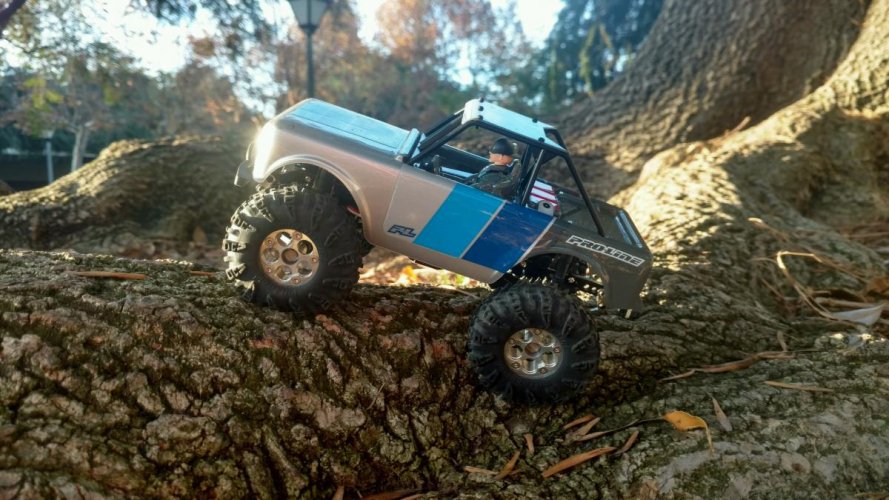

I ground my servo mounts also, makes a huge difference. I took the springs out of the rear shocks but kept them in the front for clearance. And took the leaf helpers out of the front but left the rear. Wheel weights on both bumpers and servo, and metal wheels really help keep the wheels on the ground and allow the suspension to work. I would for sure weight my stock wheels or get metal ones.
Also came up with a non-permanent way to color the shocks.
Heat shrink tube.
I removed the helper springs front and back.
Added the wheel wideners, heavy wheels, and tires from my Losi.
(Going to have to trim the body and front bumper if I decide to keep them)
Still doesn't flex much... but is a bit more stable.
Going to throw in a Predator 80t and remove inner springs.
I do like it. "thumbsup"
