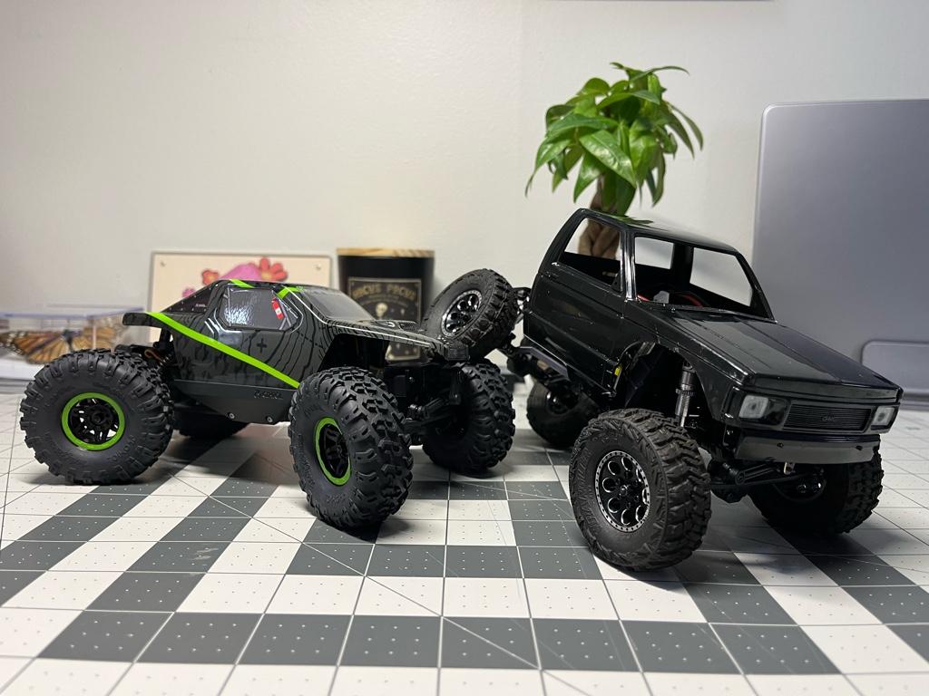

I also ordered a Lindberg 1/20 Syclone model from eBay. That arrived today and I did a quick mock up. Basically just layed the body on top to see what the wheelbase looks like unmodified.
Looks like the beginning of the beautiful friendship. [emoji3]

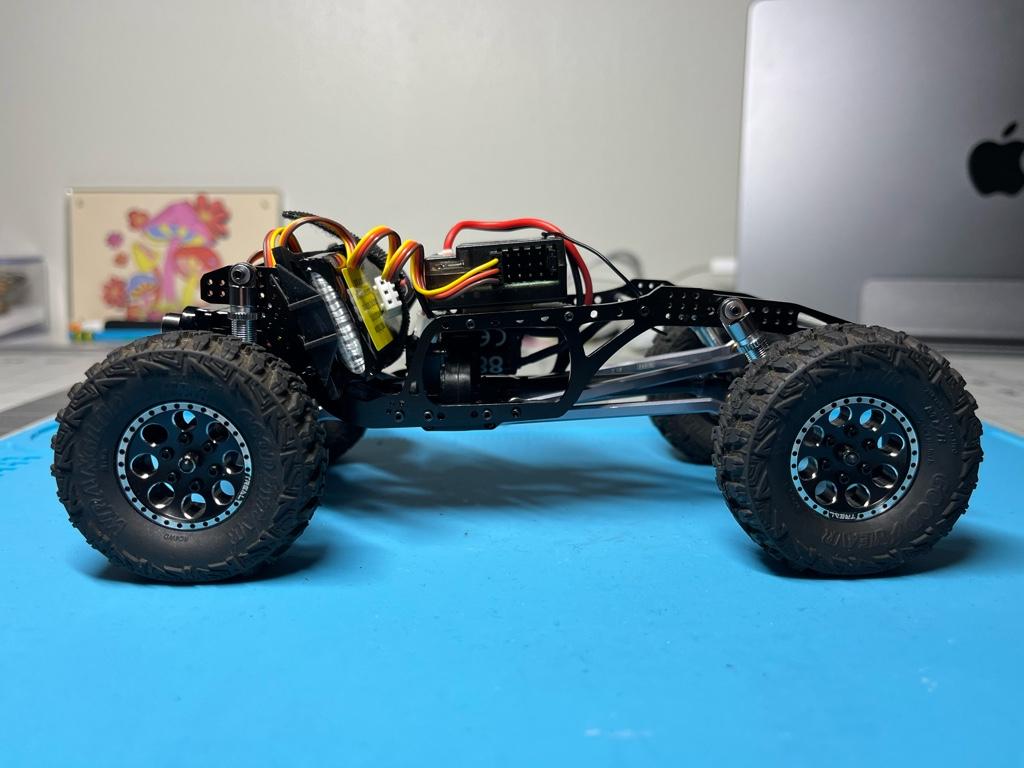

MOFO Ugly ASF aluminum chassis installed. Very happy with it so far. Went together nice and easy. Lots of extra screws which is always good.
The weight forward is absolutely killer. Just crawling around in the couch and I can notice a massive improvement.

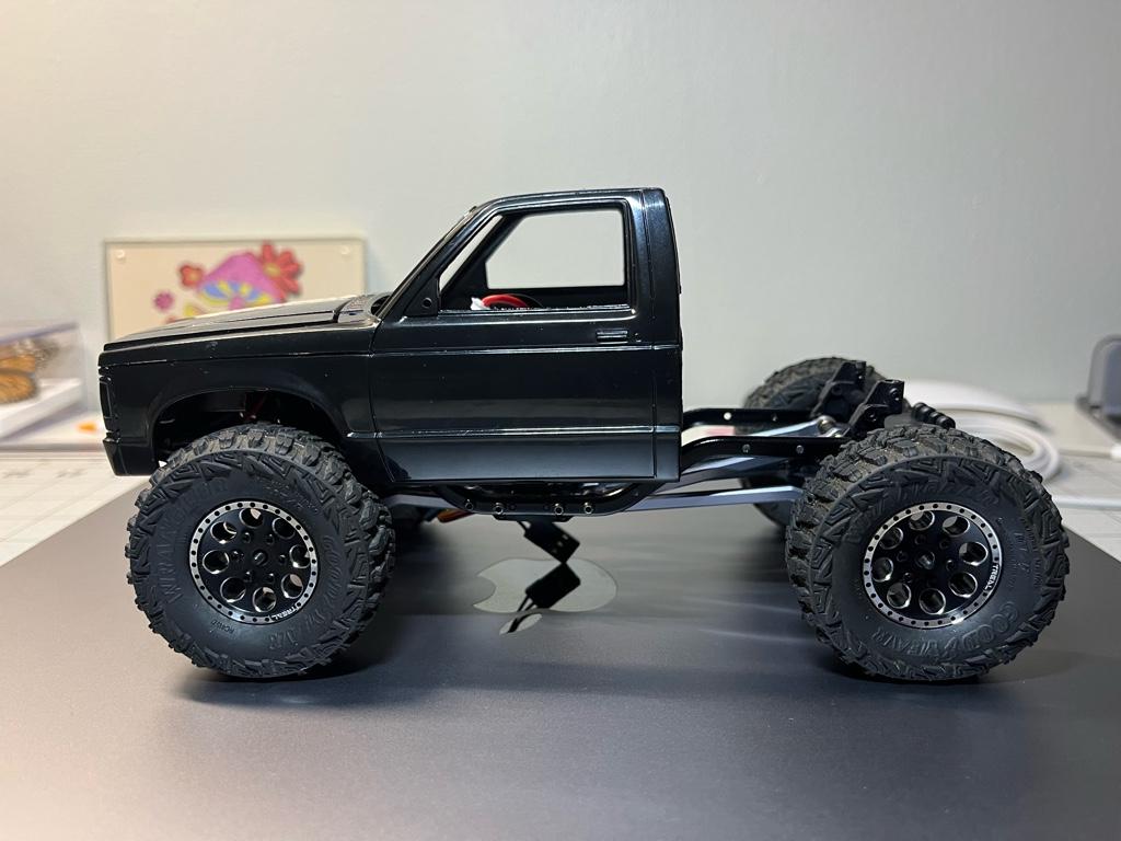

Little by little I’ve been working on this.
Today I worked out some binding issues by removing one O-ring from each shock and link.

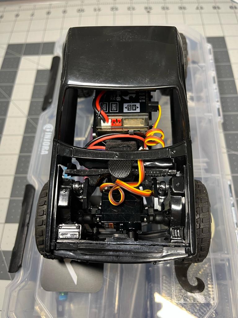

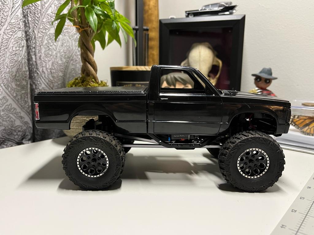

Then I got over my anxiety and starting cutting up the hardbody GMC cab. Got the fit on the rear set up and then finished up one wheel well opening.
Just a quick update. Got the hood and grill glued together. Cut the stock esc tray and used it as a magnet mount. And made a limiting strap from a random piece of cloth strap. Tied it around the top of the battery tray and the top of the 4 link center mount on the servo.

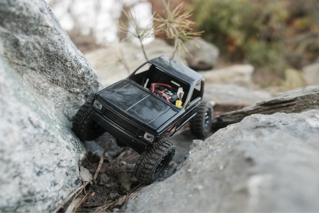

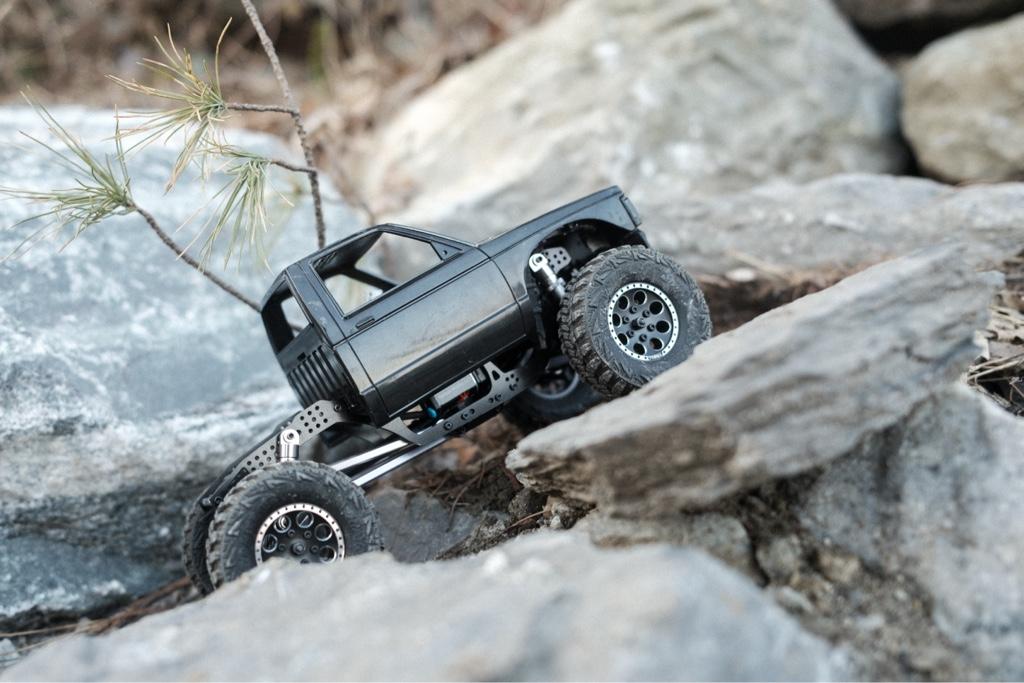

Some photos from a quick run by the lake.
