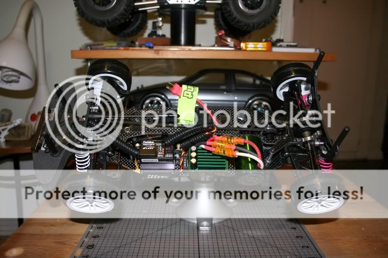

UPS just dropped it off and will start doing the build-up to a drift version.
all i need is 1 more multi-diff, got the drift wheels and tires already and some 15wt shock oil plus tweaks to the suspension its gonna drift fosho.
X2! Why? It's such a good RACER
i can always bring it back to race specs,IF i need to. the stock diffs are not gonna be built since i`m using multi-diffs which is an option part.
besides i like the way people go WTF when they see something new, got 2 here already/LOL
I always thought the the older JRXS would have made a good drifter with the motor up front and the battery down the middle of the chassis. I would strongly suggest constructing some sort of lexan underbody to protect that carbon fiber along the sides of the chassis.
will use CA on the sides, all chamfered/open edges and specially the front of the chassis, just like in rockcrawling drifters want to show off battle scars too "thumbsup""thumbsup""thumbsup"
Yeah, but my crawler isn't built from carbon fiber... carbon fiber doesn't dent or scratch, it's chips and peels; CA just delays the inevitable.
time comes to cross the bridge i`ll do it with a new chassis, those are easy to come by, infact i got my eyes on a EU spec which is 2.5mm
its done, well still waiting for lipo, battery holder, springs. spool rear, ball diff front didnt install the multi diff since i want to try drifting old school.
Nice drifter it looks wicked with the Porsche body on it. I've been thinking about using my new built 007 as a drift car.
drift is big out your way and you got better access to xray parts, 2.5mm EU chassis is best. multi-diff the front and rear spool "thumbsup""thumbsup""thumbsup"
Looks awesome, I just scored a XRAY T1 on ebay for cheap. I got some T-drifts, a 19T trinity motor, Novak XRS, and a spare receiver for my DX3R. I'll try and post up some pics when I'm done.
