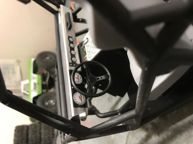

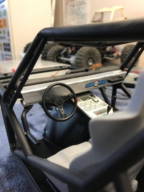

I had my Wraith built up with all sorts of scaler items, aluminum body panels, LED light bar up front, rear light bar, fuel cell, hi-lift jack, fire extinguishers, etc. Since I'm building a true 1.9 scale Truggy, I figured I'd get the Wraith back to fighting weight and bag a lot of the non-essentials. So far, I snubbed the front nose, did a type of FastBack mod, blacked the interior floor pan and patched up all the old LED and accessory lighting holes in it with aluminum, I also fabbed up an aluminum dash since the old lexan one was mangled.

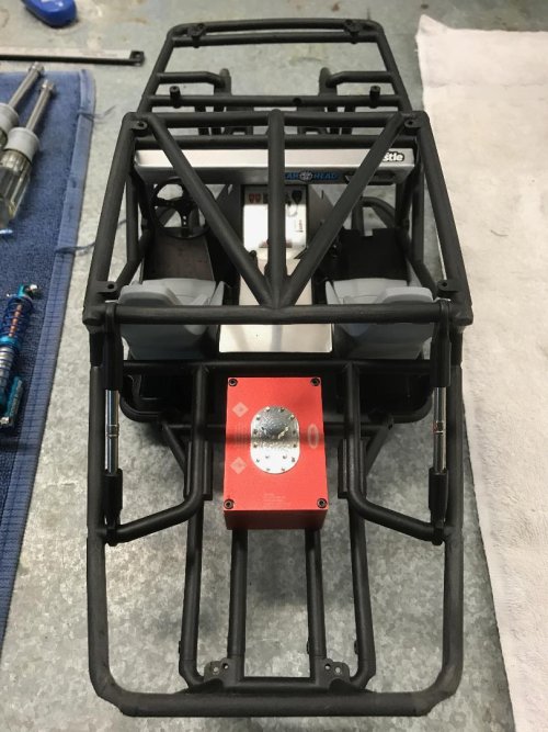

Waiting on my BGR Fab front and rear shock towers. In the meantime, I'm re-positioning my electronics. Receiver used to live up front, and ESC road shotgun with passenger seat delete. Using an RC4WD fuel cell to position the receiver out back, moving the ESC up front where the receiver used to be. My PullerPro 3500kv and BLE are due here Wednesday. Can't wait to see the difference with the increased brushless power and weight loss."thumbsup" (Was running a 13T CrawlMaster and BR-XL.)

Nice! I always seem to build heavy rigs but I've been looking at a few areas for weight savings on my Wraith and I happened to pull one of the seats out and man are they heavy, they seem to be solid plastic and pretty thick. Anyway I picked up a set of the Gmade Gom seats which are definitely lighter and a similar size.
I may just get started on that tonight and I can post up a pic and some weights of each if you'd like.

Okay I finally weighed the Gom seats and they aren't the huge weight savings I had hoped for.
The stock Axial seat is 1.9 oz, 3.8 oz for the set
The Gmade Gom seat is 1.4 oz, and 2.8 oz for both
So 1 oz of weight savings, oh well at least it was something :roll:
side by side, the Gom seats are 3/8" taller and 11/16" wider at the bolster
Also the side bolster sticks out farther, just a bit past the cage. The interior panel could likely be trimmed to allow the seat to move inwards. Maybe with some heat these can be bent inwards as well.
RPP has the seats for sale though I imagine there are better options out there, maybe a 3D printed one since it should have a honeycomb inner structure.

I’m lovin the dash also. How is it mounted? I may have to bend one up!
Hang up and Drive
Hey Mike - I mounted it the same way as the stock lexan unit. Just measured up and marked out the two holes that mount it to the Trans tunnel. Even used the same hardware. I laid all the patterning out on the aluminum stock with a Sharpie first. Then cut to the outer perimeters, did my bends and cleaned up the edges.
