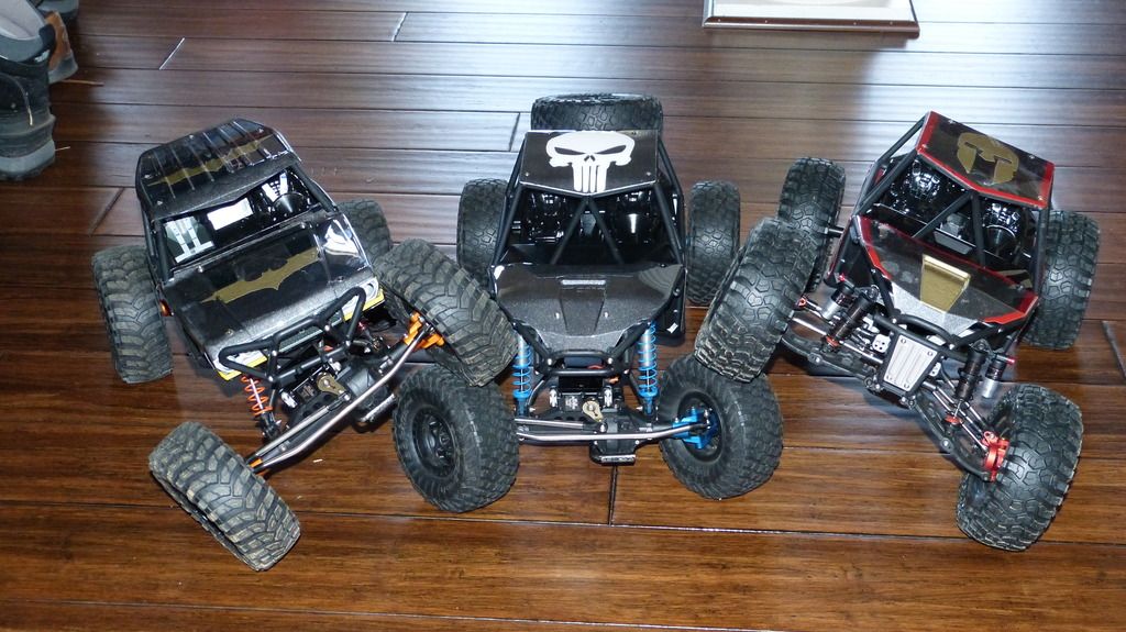

Sorry to bring this post back from the dead. Just wanted to thank everyone here that helped and offered up excellent advice for me. Really appreciative of that. Learned a lot from this thread and also from this forum in general.
Me and my two boys really bonded throughout the build and are having a blast playing with it. Now my daughter is getting really jealous and wants one of her own :roll::oops:
To be continued I guess...:shock:
Some completed pics of our 3 rigs.
Kids playroom taken over - wife not real pleased with this. 8)
