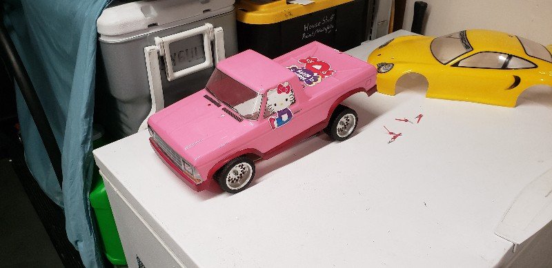

The smaller Hpi 79 Ford body fits ok. (Daughters)In that pic i posted its set to 280 WBYou have any new other bodies? I missed out on a few skylines. Enough thread jacking

In any case, I have the subie body and the HPI F150 for my Nitro. F150 looks great - low and sleek, I would have gladly put that on my electric conversion, but I already cut out a big hole for the motor. That one is cut out, but unmounted and unpainted (someday I'll get to it... )
What HPI body is that? Savage? Looks like a good fit!
