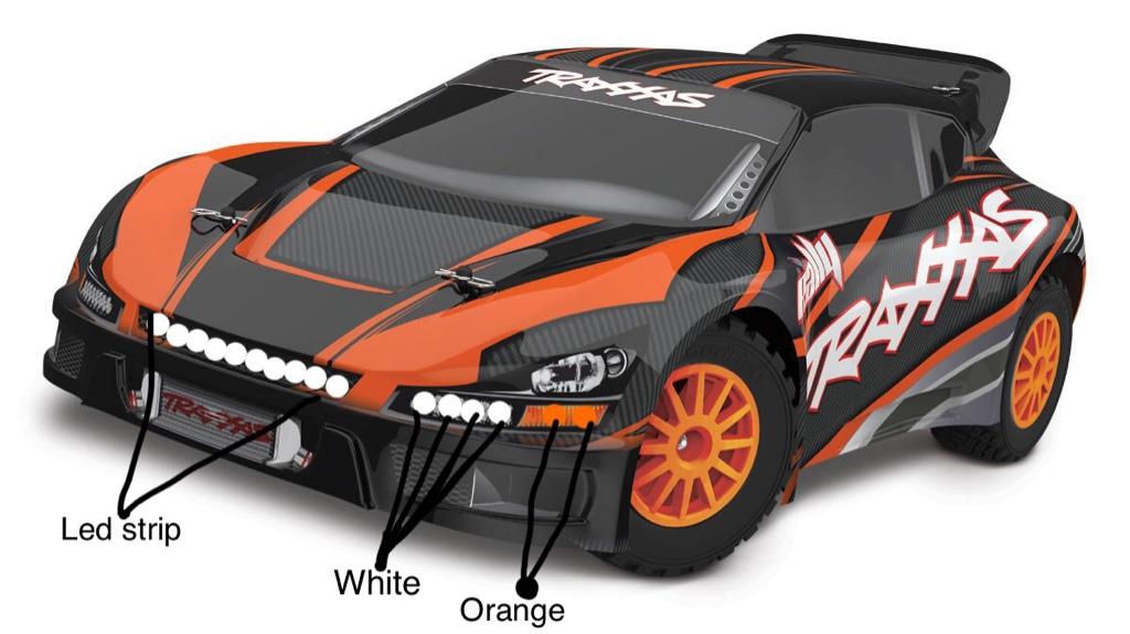

Hello guys,
I’m new at this forum, my friends recommended this forum for me to find electrical help about RCs. I’m not new in the RC world, I own my first car 6-7 years ago.
I want to make a good and powerfull led system for my Traxxas Rally. I’m planning to use 8x 3mm white LEDs to front headlights, 4x orange LEDs to front headlight corners, 6x red LEDs to the rear and few centimetres of 12V 5054 led.
I’ve chosen 5054 for high intensity and reliability, will make a small stand to set the front grille angle to 90* to ground (because as you can see at the photo, front grill is looking upwards). And I’ve chosen 28 AWG wire.
I have four questions, the first one is, which resistor should I use for each led? All LEDs will take energy from the receiver and as far as I know receiver port gives ~4.5-6.3 volts.
Secondly, which remote should I use for this project? I will be so glad if anyone recommends me a remote that can turn on and off the specific lights, as I want/need. E.g. button 1-headlights and taillights, button 2-Light bar at the front grille.
Thirdly, what type of wire do I need to use for 12v led? Last question, how can I get 12v from 4.5v-6v receiver port?

I know you don't want to hear this, but I wouldn't do it the way you are. That LED tape will not give you the flexibility you want.
I would run with Common Sense LEDs, they are good up to 12 VDC and they come pre-wired with the resistor. (the link at white 5mm, but you can get them in 3mm and just about any color you wish).
Second, to get the voltage up, recommend running an external BEC, set it to 8VDC and 3S packs. This will be plenty bright.
Third, the are a number of remote on/off switches to choose from. I like Pico Switches, they are compact and easy to set up.

The resistor is what makes the 12 volt LED light up off of only ~5 volts. So if you use 12volt LEDs, then you need the appropriate resistors (for each LED) so that it will light up with only ~5 volts.
Soooo ... easiest to start off with 3-6 volt LEDs - then you don't have to add all those resistors and do all that soldering - either someone did it for you, or the LED was created for that voltage. And ... prewired is even better yet!

you have it backwords the resister steps down voltage they dont ramp up the voltage
you can also wire the leds in series and wont need resistors as the led itself is a resistor
white lights run off of diferent voltages than red or orange leds and would need a different resistor or more leds in series
other colores have different voltages too
