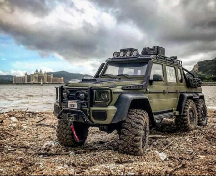

Hey guys, it looks like there's enough of us that have picked up TRX-6's that I can start this thread up and going!
Here's my trx6 to many mods to say. [emoji28]
But my favorite mod is air suspension it helps a ton on the trail and rocks.
Post anything of what you did with your TRX-6 today. Maintenance, upgrades, crawls, trails, pics, a video anything.
What have you done with your TRX-6 today?

Like the paint job!! Don't think I've heard of air ride suspension for RC cars. More details please.
Capo air ride you can program it to help with sidehills or climbs, you can lower the front or rear independently or sides independently.

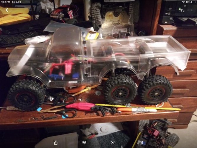

Just joined but have been following posts for a while. I put the black body in the box after purchasing the Traxxas Trx-6. I will post pics after I learn to navigate the site. I bought two Proline Dodge Powerwagon bodies and joined them together.

That should be an interesting body for the TRX6, can't wait to see the pictures of it.

I am not shure what I am doing here about transferring photos and how to size.

Thank you...it was a fun 1st build. I have made my Defender into a pickup but that has been the extent of my truck body mods.
Thank you....I was able to stuff in the motor speaker up front but could not lower the body anymore.
