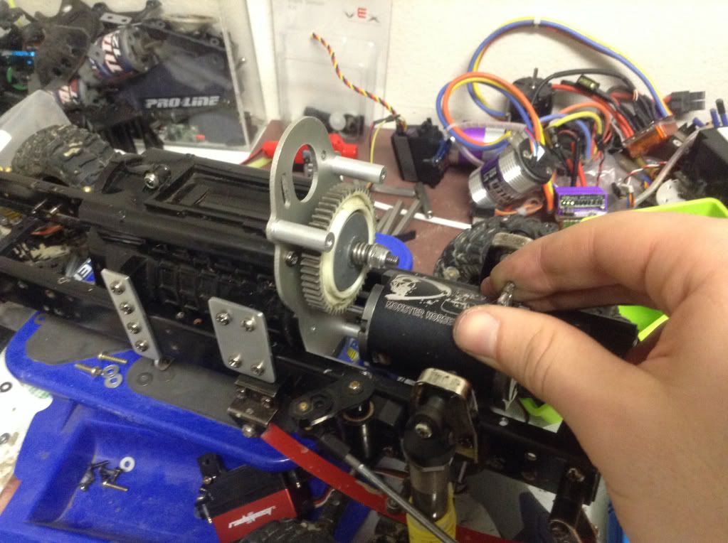

I made a bit of progress on the trans-lift today, too. I still need to do some more machining on the motor plate, but the machine shop was closed today.
MUCH BETTER!

I love high lifts. Great job so far. May I suggest mounting your steering servo up between the frame rails and slick towers. You can actually fit both the shift and steering there.
Otherwise it's looking good
Well... there's sort of a motor there now... but I have been looking for places to mount the steering servo that will get rid of the little middle-linkage doodad. I think I found one, it'll take a custom plate, but I already have plans for a winch plate, battery plate, and body mounting plates, so it shouldn't be a problem! I am thinking of trying to squish it up in the front like a panhard mount, and changing the steering linkages to the front, like on axial axles. I DON'T think the shocks will get in the way... we will have to see. I think the biggest obstacle is the leafs, but there's nothing a bit of creative link bending can't fix.
