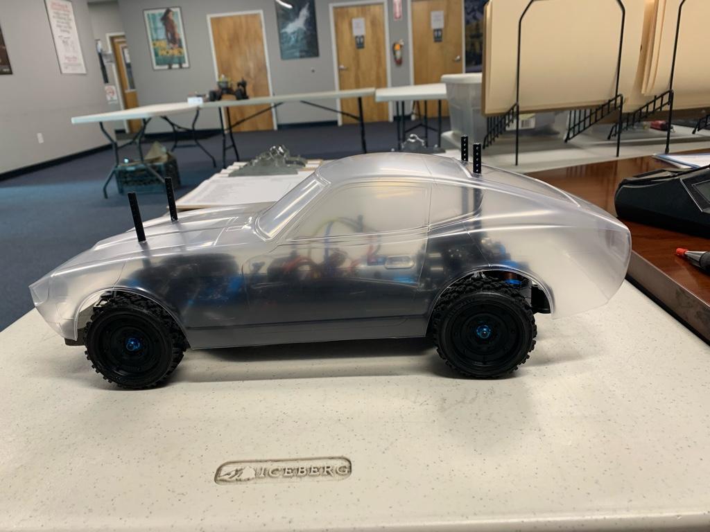

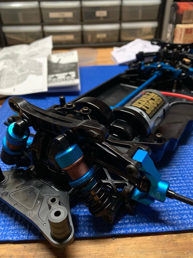

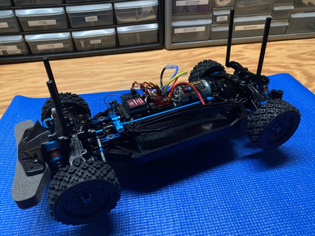

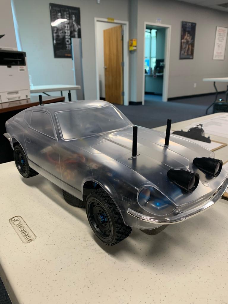

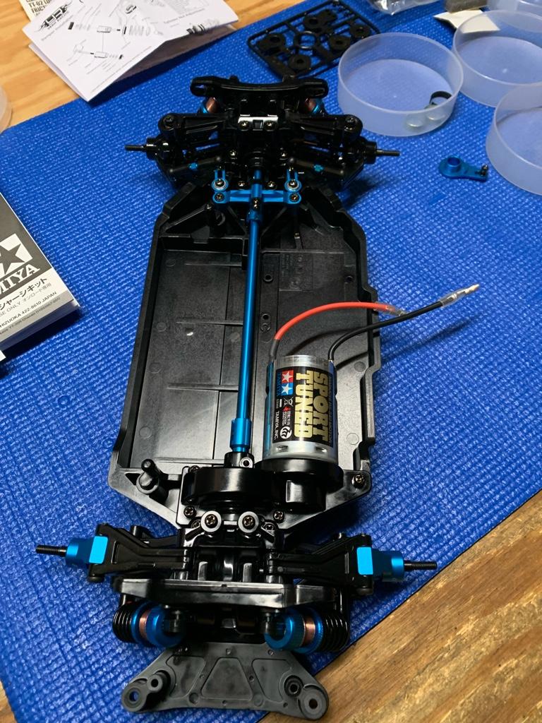

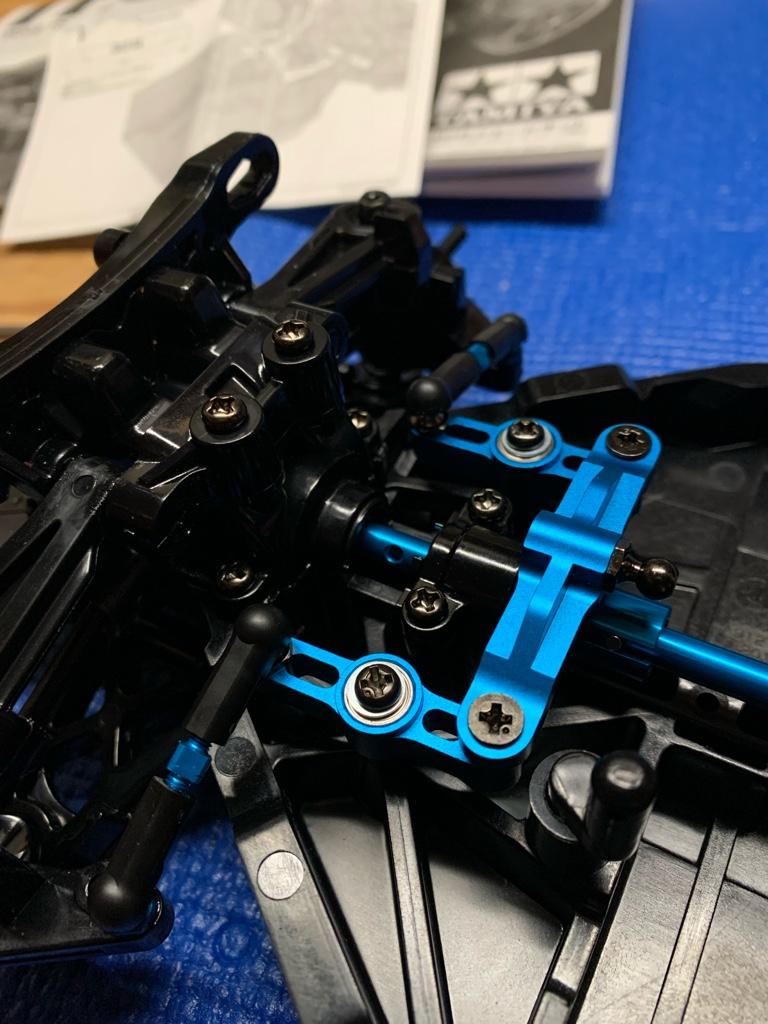

Finally getting the time to build again. Building this up for light rally with a Datsun 240z rally body. It’s coming along nicely. The Tamiya steering set is amazing. I’m also very happy with the Yeah Racing Shock Gear shock set. Five different spring sets, many pistons, and titanium coated shafts, and oil included. 3 racing diff cups and axles front and back. Using a sport tuned motor on 2s.

Thanks! I originally bought a basic tt02 kit just because it has adjustable wheelbase for the 240z body lol. I ran that body on a DF03ra and loved it. Wish I never sold it 10 years ago but oh well. Then I got the Tt02r kit and added cvd driveshafts, Fast Eddy bearings, steering set, steel suspension balls, and some Yeah Racing shocks. It’s just about finished just need some aluminum wheel hexes and axle shims which have been ordered. It won’t be a shelf queen but I’ll definitely take it easy on it. Tt02’s are not the best performance wise, but they have a certain charm. I’ve done the 240z body before and it turned out rally box art great. All these years later and hope I can do it again. Oh yeah, and the WRC Yaris body that came with the basic kit is going to look great on my XV01.

Thanks! It was a fun build. I started with a Tt02r so it had some upgrades from the start. Here’s a list of some upgrades.
Tamiya steering set (more expensive but worth it). Comes with a great servo saver as well.
Yeah racing steel cvds and drive cup (if I had to do it over I would go with Tamiya cvds but these are nice for how cheap they are. Had to shim the axles at the wheel pin/bearing on all four corners.
Yeah racing shock gear 55mm shocks. These are awesome for how cheap they are. Comes with 4 or 5 different spring sets and and great selection of pistons. Smooth well made shocks. The mounting balls come with them as well. Balls are slightly smaller than Tamiyas so you have to use these. Nice fit.
Tamiya aluminum propeller shaft and joint cups.
Tamiya high speed gear set
Tamiya aluminum motor mount
Fast Eddy bearings
Tamiya 3 degree rear hubs (came with Tt02r kit).
Hitec servo
Hobbywing 1060 esc
Tamiya sport tuned motor.
I think that covers most of it. I can’t wait for better weather so I can paint the body. Have fun with your build!
