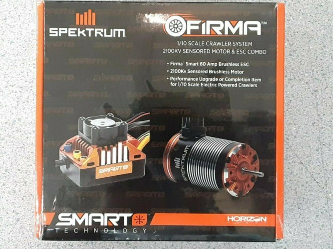

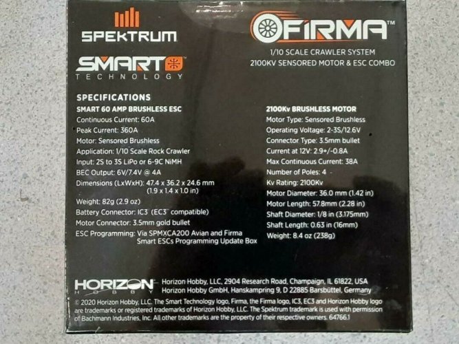

Hey Man I just purchased the new Spektrum RC Firma Crawler Sensored Brushless Smart ESC & Motor Combo 2100kv and ill let you know how that handles it seems pretty versatile for my Gspeed project but would work well on the TRX4 and TRX6 the only thing I could see as a problem would bee the sensor cable is a little short and not sure where you want to install your esc? But check it out and ill keep you posted and hope the Hobby Wing Axe works for you they are great ESC's and Motor's..... BUZZZZZZ.....
