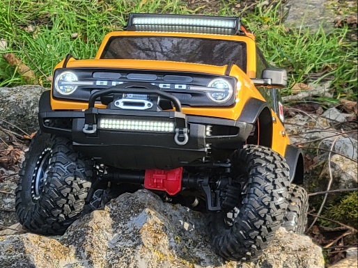

Couldn't seem to find a Bronco bumper from Traxxas that accepted any light bars so I devised a way to make it happen.
*Remove bumper bar that holds D rings
*Take original bumper and carefully dremel out the notches next to where the D rings were, do not remove the plastic in the middle
*8088 light bar holes line up perfectly with the upper D ring holes.
*Notch out the back of the D ring bumper bar (top screw holes only) the thickness of light bar bracket
*Attach light bar with wires on the bottom
*Reinstall D ring bumper bar over tabs on led bar and secure with original screws
