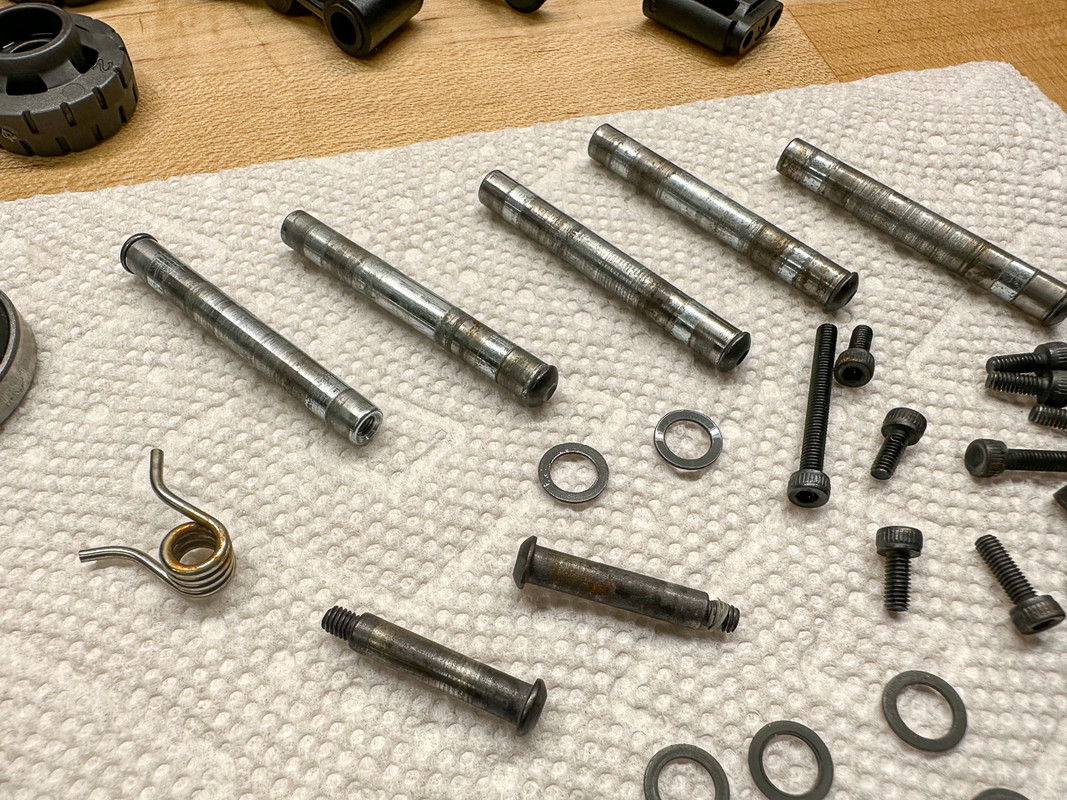

These axle pins show wear, but it's not significant enough to warrant replacing them.

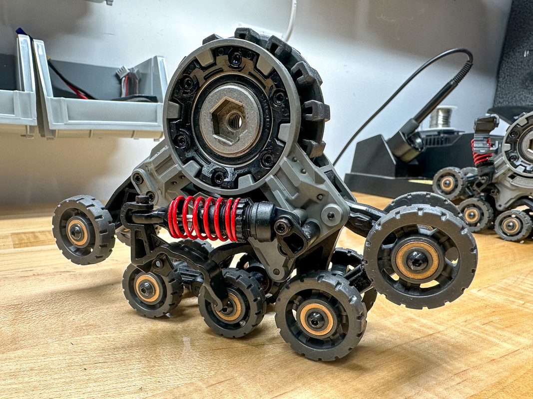

Here is the fully assembled unit with a protectant applied:
I used the same procedure for the other three assemblies.
The result is a quiet, more flexible assembly ready to see more use in the mud and snow.
