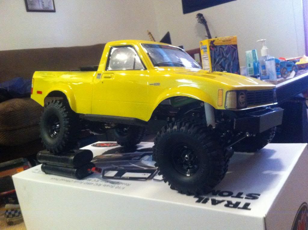

After reading about what it takes to get the RC4WD Trail Stomper setup for decent trail drives I decided to go ahead and get one. For the price i think this is a great deal for someone who isn't afraid to work on their truck. I installed the axle front c braces, removed the internal springs from the shocks, moved the battery up front, replaced the front drive shaft with a traxxas one , and replaced the rear one with a left over tamiya cc01 yj shaft that was the perfect length. I also put a 16t pinion on the motor to get some more wheel speed. I built a front bumper and tool box out of styrene for added scale looks.
http://i865.photobucket.com/albums/ab214/isk8harder/febuary074_zpsca646377.jpg

I just drove it around the house stock it has almost no flex with the springs in the shocks, once you take those out it starts to work a lot better.
If it's anything like the TF-2, the springs should soften up a little with use. Could we see some body-off shots? I haven't seen much of these rigs.
