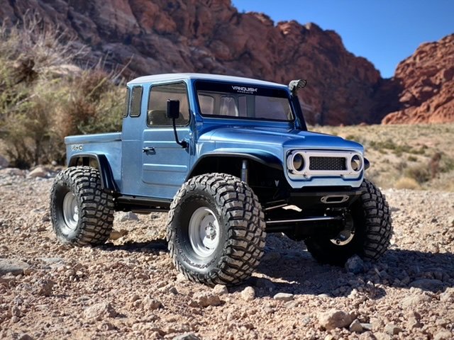

And the latest build was a VS410 phoenix. I had a couple extra sets of 10.3 straight axles around when the kit showed up so I figured I’d mess around with an axle swap to see how easy it was and just ran with it. Going to steal the F10 portals for a new gspeed build on the red CF rails.
Overall the swap was really easy. I needed a different panhard link, ended up using a 73mm factory team link with the Traxxas rod ends to get to 87mm eye to eye. I had to extend the front upper link a tad as well to give enough clearance for the spring cup. Running the stock 80mm shocks but with losi mini T springs.
I’m also using micro servos for the dig and OD selector. To do this I’m using the nsdrc micro servo adapter plates. These need a 24mm horn which I managed by taking the longest plastic horn in the package (originally had two arm) and snipped one off, then drilled the 24mm hole out to fit m3 hardware. They got the job done great on the shakedown run. Soon nsdrc will have a spline adapter that will allow full-size horns to be used on the micros but this set up should be fine for now.
Paint is Tamiya anodized blue, backed with black. The rooftop is pearl white, backed with normal white and then silver. Fenders black on the inside and matte clear on the outside. I dyed the diff covers black as well since the red would have stuck out like a sore thumb with this paint scheme.
Wheels are incision KMC Roswell wrapped in class 2 proline km3 tires stuffed with proline dual stage foams. Since I’m running 10.3 straight axles and have a normal sized stub I was able to used the SSD hubs for a clean final look.
The motor is a Holmes puller pro 2700kb 540 can paired with a copperhead esc. The esc has the case and fan removed and just barely fits under the interior on the slider. It pushes on the interior slightly but not enough to bother me. I used the stock 52t spur with keeping in mind I could swap to the 56t spur if need be but the throttle control felt great on the first run and it had nice wheelspeed so no plans on changing.
The truck is no line killer, especially with 0 added weight and stock shocktowers but it’s a smooth and enjoyable drive. Pretty happy with the outcome.

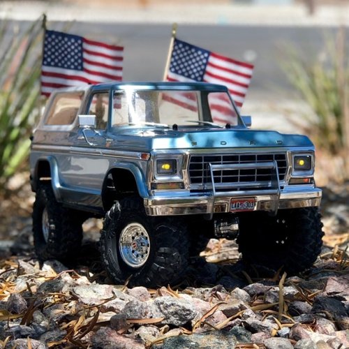

Firstly (but last pic) I’ve acquired a new trx4 after falling in love with the 2021 bronco body and the new colors Traxxas release. Put in some work so far but still a ways to go. At this point I’ve matte cleared the top, replaced the spare tire with the classic bronco spare tire carrier, added led lights, brush guard, cut a visor decal, vp wheels and 4.45 rock beasts, and the roof rack with some scale bits. Still need to swap out electronics and do a couple other things before hitting the dirt with this beauty.

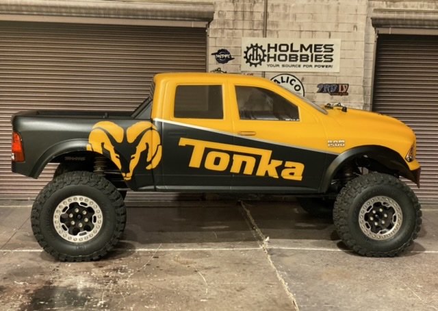

I also did some refreshing on my other trx4. I found a Dodge Ram monster truck body I wanted to try out so I stretched the trx4 and painted up a tonka theme. Still need to get a driveshaft and mirrors on this one.

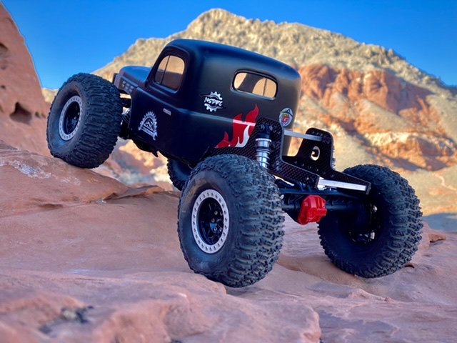

Painted a new cab for the rear portal Sherpa and swapped to red carbon fiber gspeed rails. Love em.
Then the Sherpa got a new portal only transmission from dlux. It’s tiny af and j love it. Big fan so far.

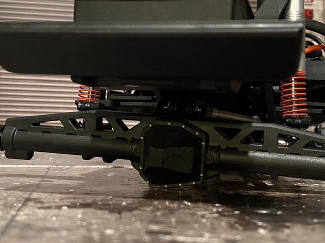

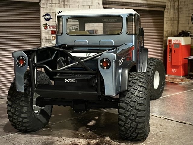

Also did a gatekeeper rear suspension swap on the Knightrunner. Can’t really tell in the pic but it’s a fun set up to trail with. Using left over parts from the gatekeeper kit and the Knightrunner rear suspension/links to build a lwb enduro with the prairie wolf body on it.

The Bronco looks great! As I said on FB, the close up shots with the lights on look so damn real! Excellent work on the other rigs as well! The revamped Sherpa is on fire!!
