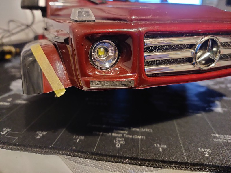

Then it was time for the fender flares. I didn't like the look of the rubber Defender fender flares. They were too big for the look I was after. So trimmed the existing ones.

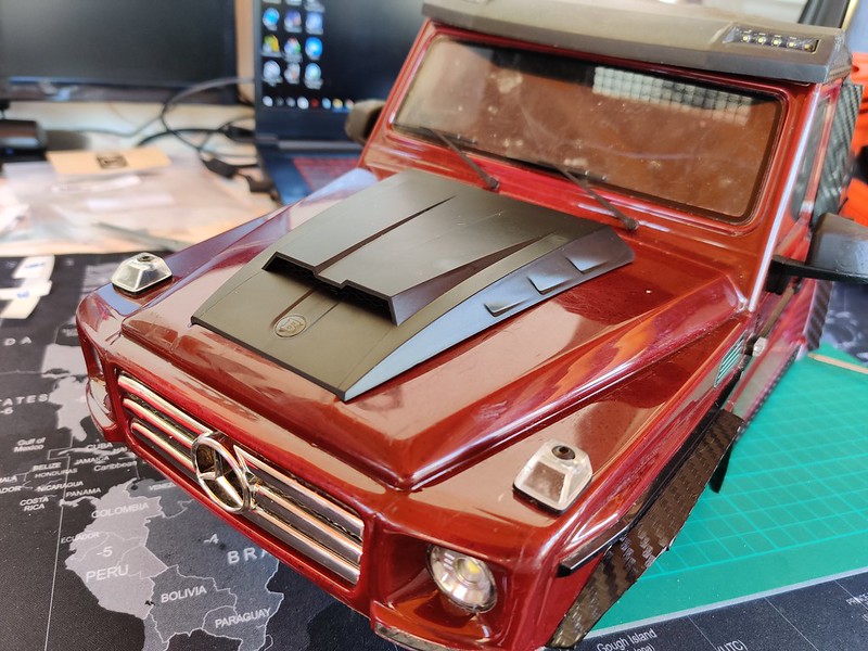

GRC Engine cover
I like the look of it. It has some nice lines and I'll probably add some carbon there as well.
