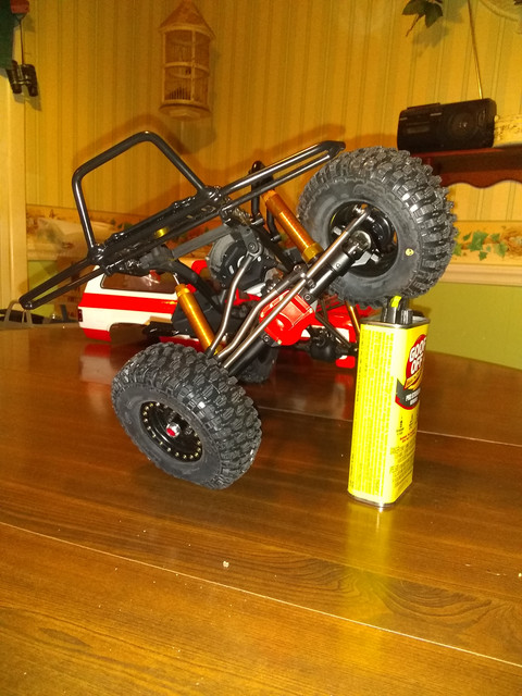

SSD Kit built up, minus shocks. Without Shocks, look at the flex in this thing.
Almost makes me want to run with nothing but a set of limiting straps. With the 90mm SSD Shocks, the flex is really limited.

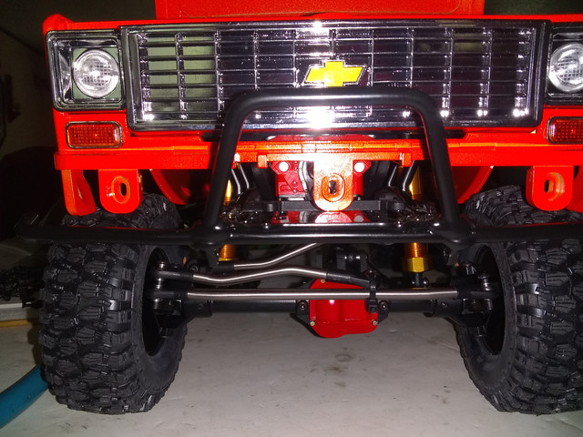

Werty Front shot
The Werty will also be mounted outward a bit more if I do end up centering the front axle/wells.
