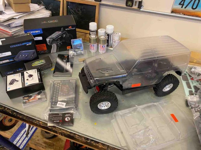

My local hobby shop happened to have a display model 10.3 kit heavily discounted. I ended up getting an HW kv2700 esc combo sr515 dx5c rx/tx wp120t steer servo 400 oz. all recommended by the store.
Plans for tires and wheels Friday when shipment comes in to the shop. Have club 5 hinge kit spare tire mtn and a few other things mytrickrc light kit steel rock sliders on order. Wish I had a 3D printer. May have to get my brother in law to help me with printing some stuff.
Plan on bumpers and winch brass diff covers and we’ll see what other strength and performance items I decide on.
Tamiya champagne with black trim is color choice so far. Plan on using dig and keeping stock axles until Something or someone changes my mind.

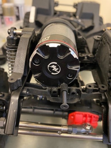

I spent a fair amount of time trying to get the motor in this thing. I started out trying to install the motor with the transmission and chassis all assembled but the leads from the hw 550 axe were too tight against the front chassis brace and it was a hair too long as well.
I pulled the trans out and got the motor mounted and thought maybe it would go in as one piec but fought the same problem for quite some time. I searched everywhere for info on whether this was a real issue or if I just wasn’t doing something right but couldn’t find anything. I finally gave up and pulled the chassis brace and trimmed it up front and actually after several more tries fitting it I cut the brace on the passenger side clear out. As far as I can tell it’s not needed with all the bracing and how everything is screwed together but maybe someone can tell me if I’m wrong and it will cause an issue or what you have done if you’ve run into this problem. I believe I will put a skid plate on the front to mitigate any possible protection I removed. IMG_2405.jpg
I also had to do some trimming to get the steering servo to fit.

If you check out the tips before you build sticky at the top of the page, I think it covers both issues. I had to trim for my steering servo on both 10.3’s I’ve built. But I’m pretty sure it was noted that a 550 wouldn’t fit without some trimming also.

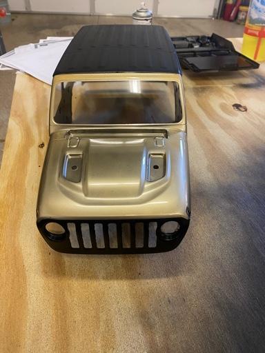

Wheels later today and praying this looks better after the overspray film is off. 1 more coat of bed liner to go [emoji51]
Pretty stoked about the paint. Turned out really nice for my first body. Maybe one more coat of champagne before backer but you have to look pretty hard to see the imperfections. Did the rust oleum bed liner on the outside for the black. Has a perfect texture. Got wheels as tires. Bronze ssd prospect and trencher predator grip tires. Everyone is out of hyrax[emoji2368]

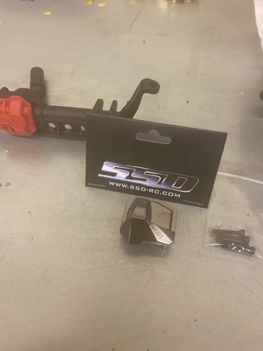

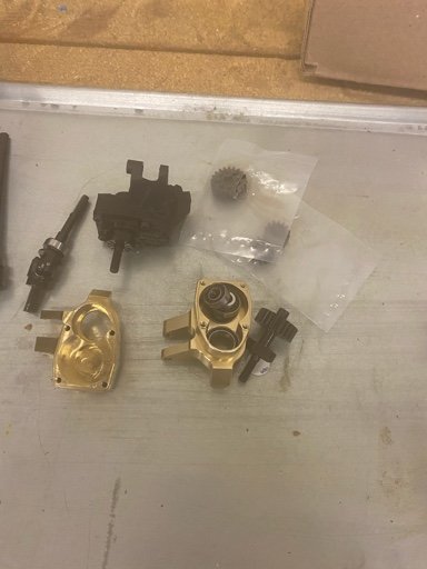

I moved on to my ssd brass diff covers and thought I would also do my hobby park brass knuckles ssd front portal over drive and halfway in realized my Samix portal covers are due to be delivered tomorrow so I can’t finish that yet IMG_2439.jpg
I really like the looks of these covers. May have to paint my knuckles black. I’ll see how they look with the samix portal covers first.
Don’t mix and match! I wanted all Samix portal covers weights knuckles and hexes but couldn’t find knuckles from samix anywhere.
Just spent 2 hrs shaving the knuckles to fit the samix covers then had to shave the backside of the knuckles to get the weighs to fit. Lucky brass is soft and easy to work with. I was just doing very little at a time but I had to shave quite a bit off the backside for the weights. Anyway here they are. They look great. Wish they had the rotors but this set didn’t have them. Not installing axles until tomorrow as I should have brass Samix hexes by then. I did install ssd od as well.
