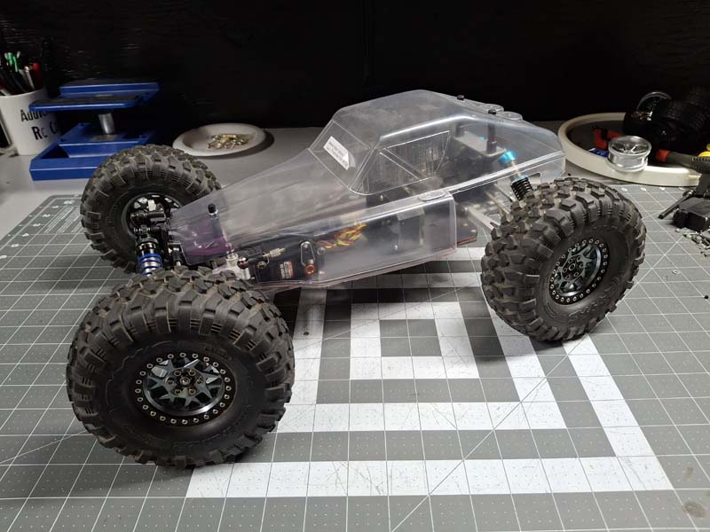

Got the trans and servo mounted, and a body cut up and fitted. I like the idea of a rock buggy (just for something different) and this old Parma body has been here for ages. Had to cut off the nose, but it tucks down nicely. With the wide MT arms, 2.2's are the only thing that looks right. I set the body on the other chassis and with the super nitro arms and 1.9's it looks pretty good too. It's good to have options! I had to move the trans back a little further than I would like to tuck under the body, but it's definitely got a front weight bias as is. I think it's off to a good start.
![20240729-191345-SM.jpg](/forums/proxy.php?image=https%3A%2F%2Fi.postimg.cc%2FpVzQxj3z%2F20240729-191345-SM.jpg&hash=d81fc9038dbcbbd7cab4ae911189ca31)
![20240729-191351-SM.jpg](/forums/proxy.php?image=https%3A%2F%2Fi.postimg.cc%2FW1WgSwJL%2F20240729-191351-SM.jpg&hash=b3b57c96d007108902b1cb9f813437c0)
