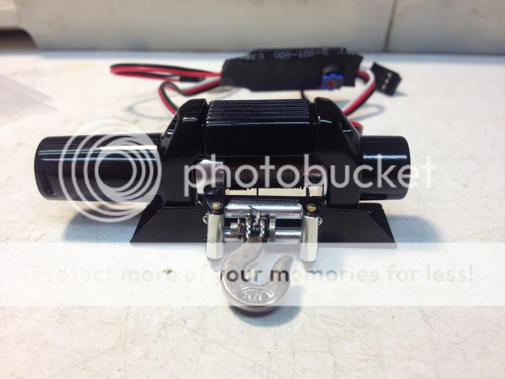

Ikaika what winch is that??

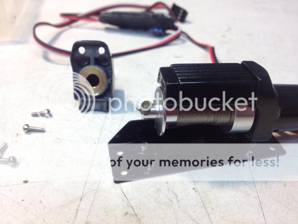

I use the RC4WD bulldog winch. I pulled it from the salvage pile just to get one on the rig before the G6.
The newest winches from RC4WD are 10 times better now than the older ones.
Heres a tech sub-thread on the new RC4WD winches. They are using a brass bushing and can seize or studder during operation, so its best to do a little preventive maintainance before install.
The case feels a bit thicker and its held together with hex hardware, still be careful not to strip out the screws or holes during disassembly/assembly

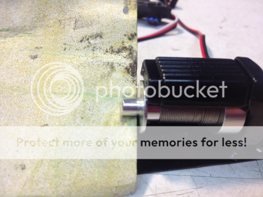

I used some 220 grit sand paper to smooth out and reduce the size of the spool stub just a little so it would spin freely in the bushing.
Put a dab of heavy grease on the stub, bolt it back together and she's good to go "thumbsup"

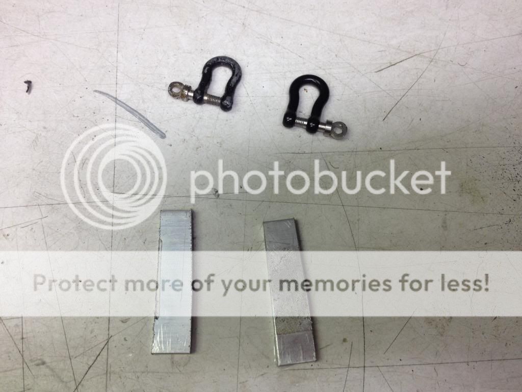

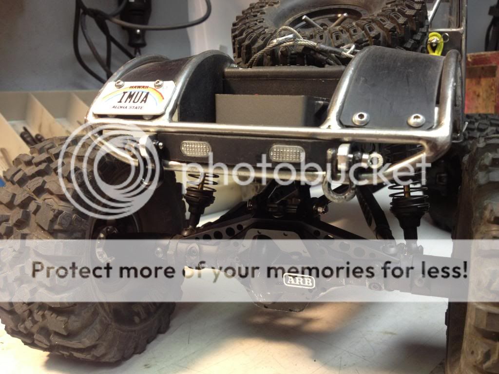

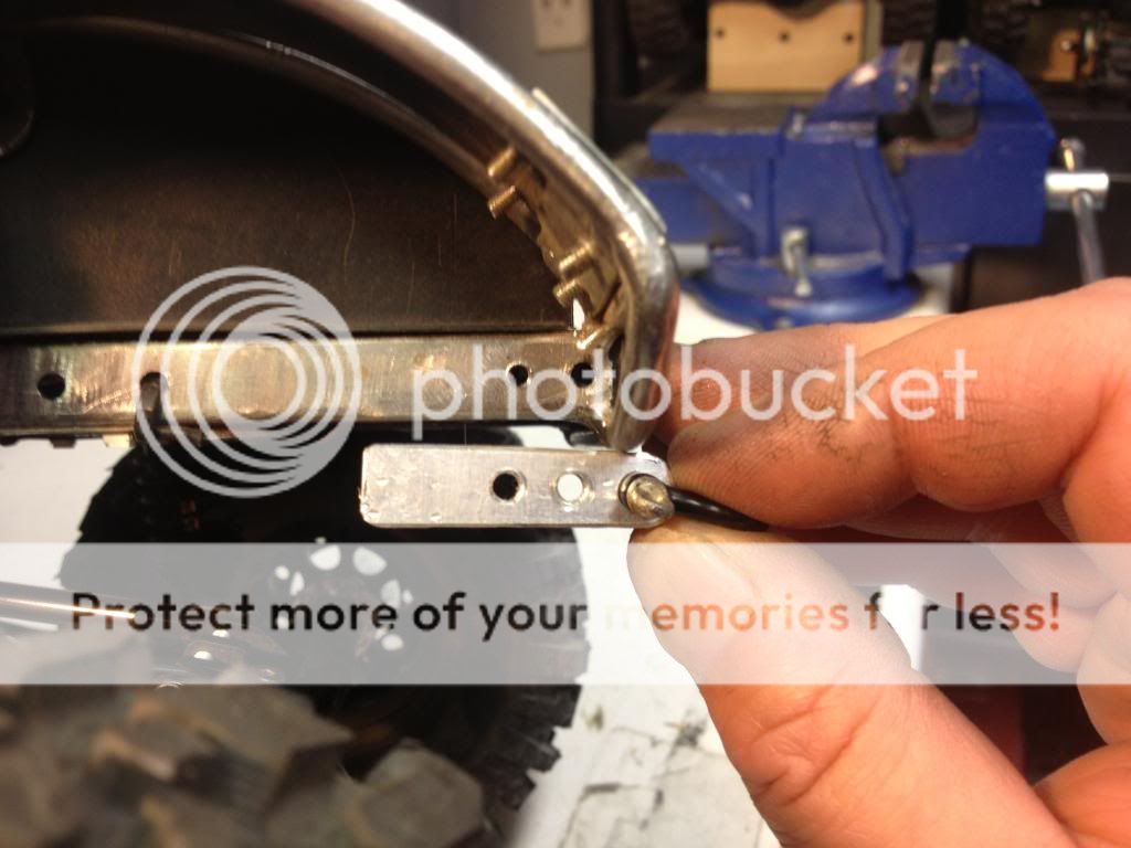

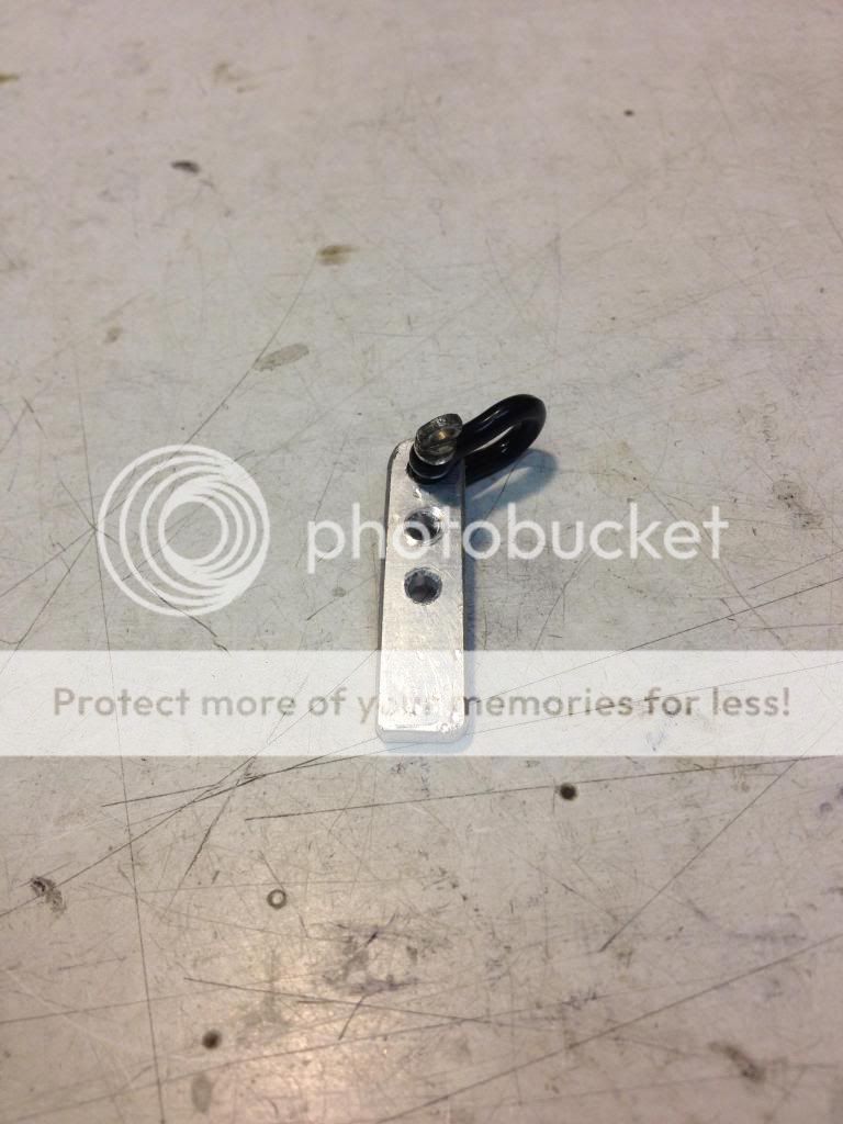

Here's my quick addition to the chassis, D-mounts for the rear
Grab some 1/8" alum. flat stock. cut down to 10mm and however long you liken and a couple shackles.
Make a template for mounting screws, filed and buffed down to finish.
Install and now you have shackles to hook up all them other trucks that need a hand

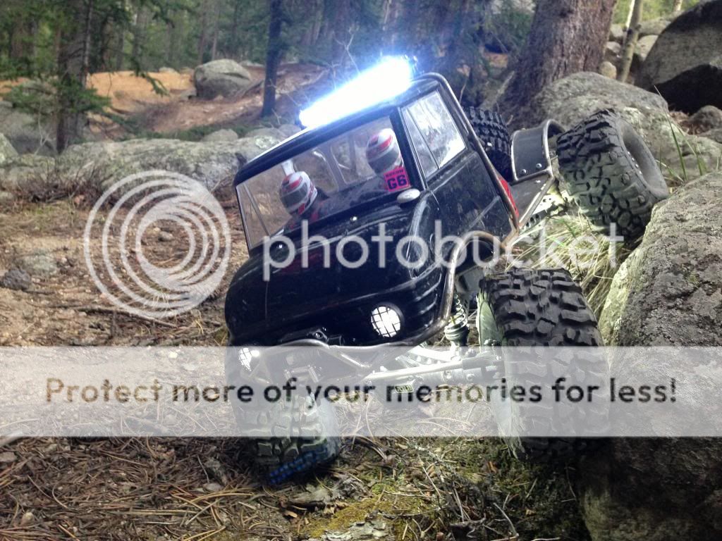

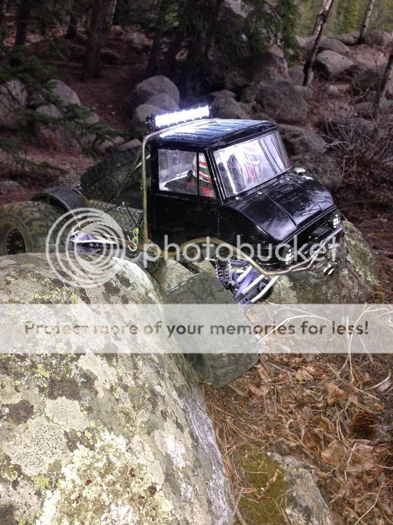

Took a weekend trip to check out a new comp spot and shot a couple pics of the Rock Bull on some awesome terrain, enjoy :)
Did manage to break the panhard mount at the axle, so I'll be fabbing up a beefier one this week and get ready for the rigs first real comp in a couple weeks :)

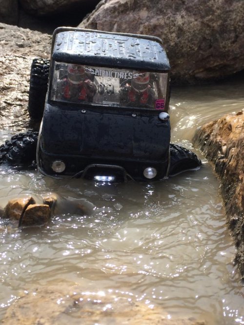

We haven't been running many scale comps lately so when the opportunity to run a weekend long event with Pro, Sporty and Scale comps at the world famous Red Rocks we jumped all over it :mrgreen:
There were 4 courses designed and layed out by 666 and Turtle and they were great! A good start for the new drivers getting into comps and still some challenges gates through every course for the more experienced drivers. I ran class III because of the cut n chut pitbulls and dig in the truck, being a pro comp driver most of the time I'm used to hittin' switches during a run, but I only used the dig once on course 4 :mrgreen:
Thanks to iluvdrt for snappin pics "thumbsup"

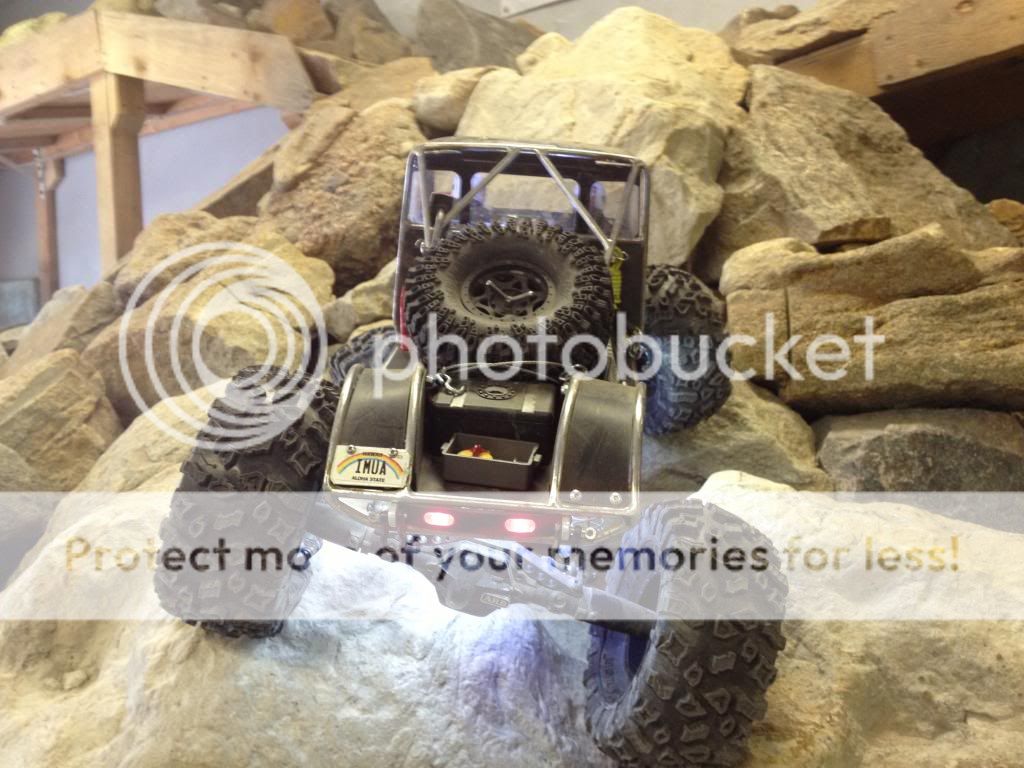

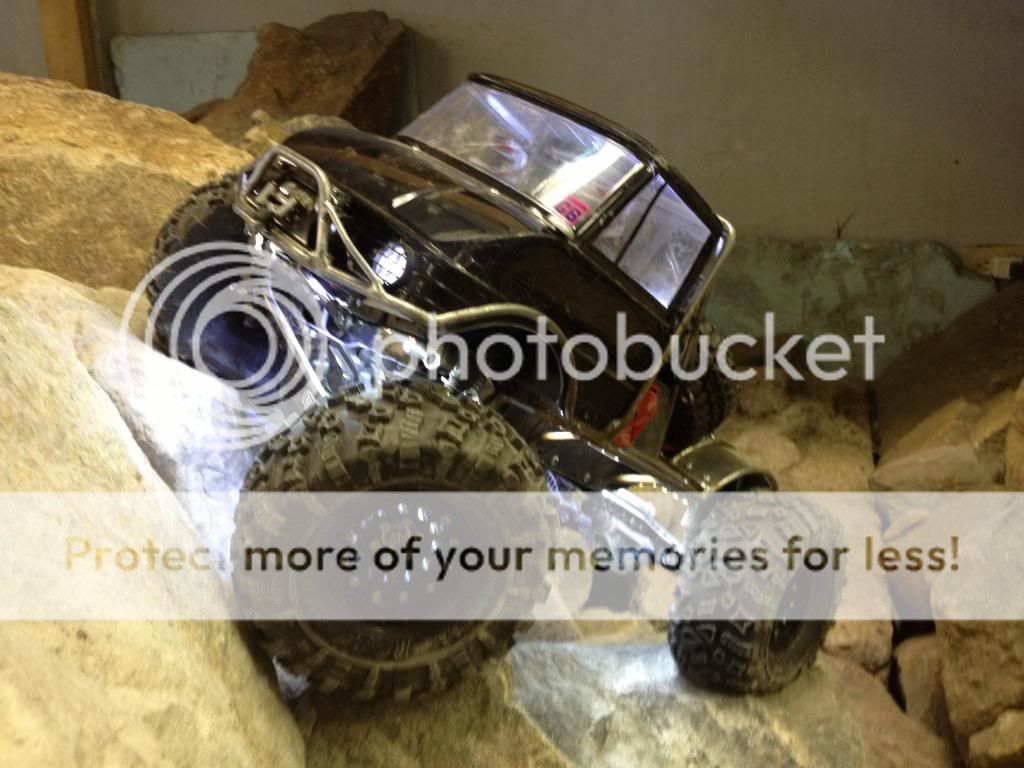

This one looks like the trucks got a mini wheelbase, lol.
This was a sharp breakover with a slight under cut, this is were the short 11.75" wheelbase helps to get on top of obstacles instead getting caught on the skid.

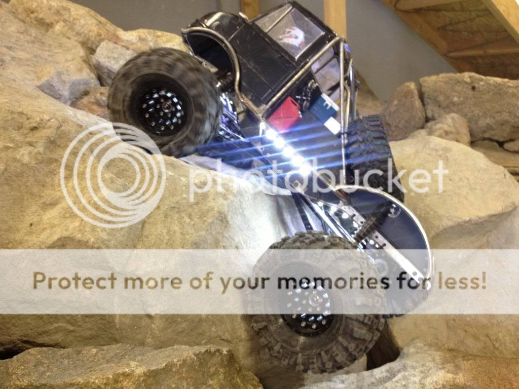

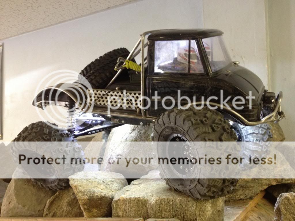

This is were the short wheelbase got me :evil: a slight off camber uphill ledge with ruts and a diff hanger cut with an O.B. and not enough room for the wide track width of the rig.
This was the only time I pulled line to winch,at least it made for a cool pic
