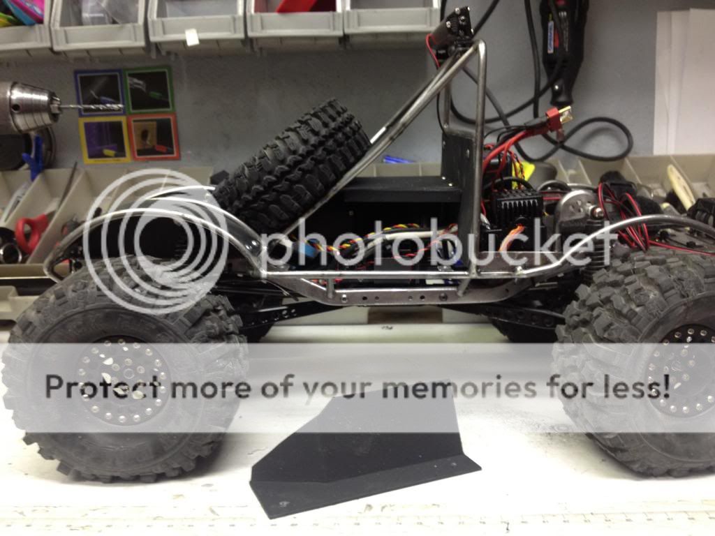

Started off with a sweet custom chassis from MG200 (top notch chassis work) Told him what I wanted and boom, its done :)

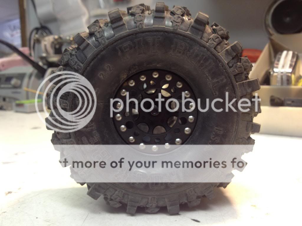

Scored these cut n shut Pitbulls, stuffed with some custom dual stage foams from Crawler Innovations and mounted them on a standard Axial 1.9 beadlock wheels with some rings from MTHead and lots of screws.
Decided to go hardcore with the axles with a set of VP SCX10 axles with the Wraith knuckle steering mod for some crazy steering and Wraith lockouts on the rear to keep the axles the same width. Axial over/under gears front and rear and a little ARB bling from RC4WD.
This is from another build I did, but you will get the idea. For the panhard set-up on the front axle I used a Wraith racing ackerman steering arm and bolted it to the 4-link truss on the axle, simple clean and easy.

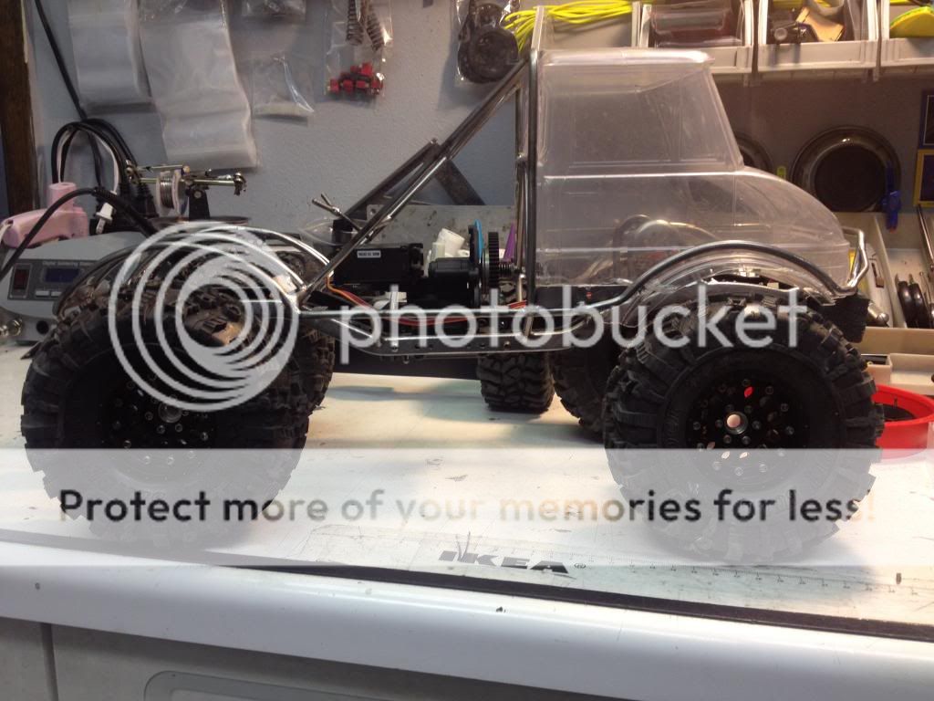

Here the truck sits mock up with the 1.9 cut n shuts.
and some old school pitbull 2.2s when its time for a TTC :)

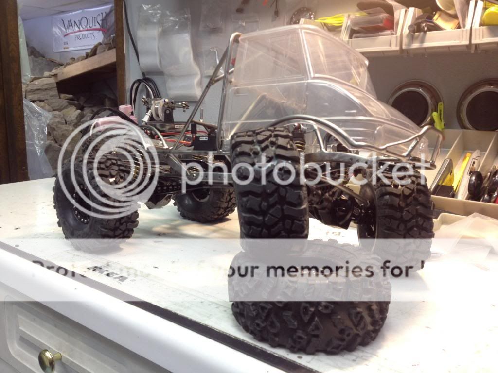

Set-up some 3.5" traxxas big bores and short springs and get the links and
suspension together. Poseur flex shot, check.

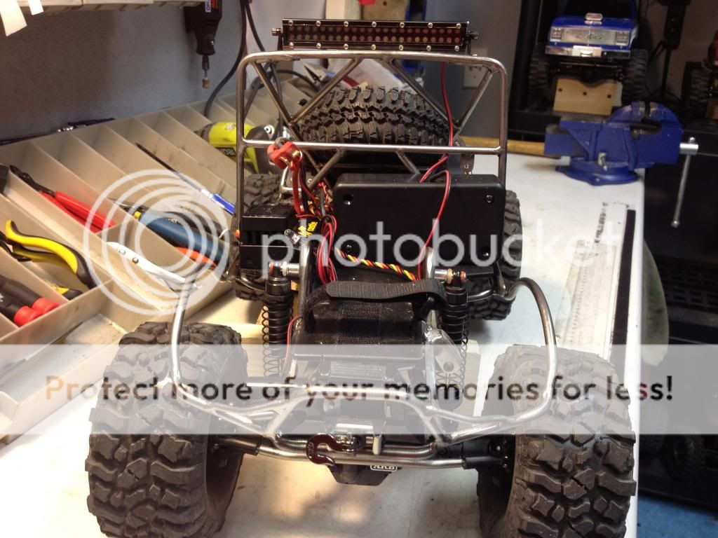

Got most of the electronics buttoned up in a project box and dipped the ESC in plasti-dip.

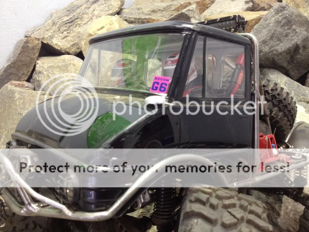

Found some time to finish this rig before the big RECON G6 "thumbsup"

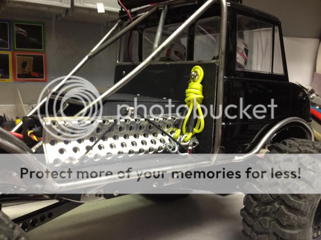

Started work on enclosing the cage with some body panels and thanks to Almighty Malach for an idea, I came up with these things.

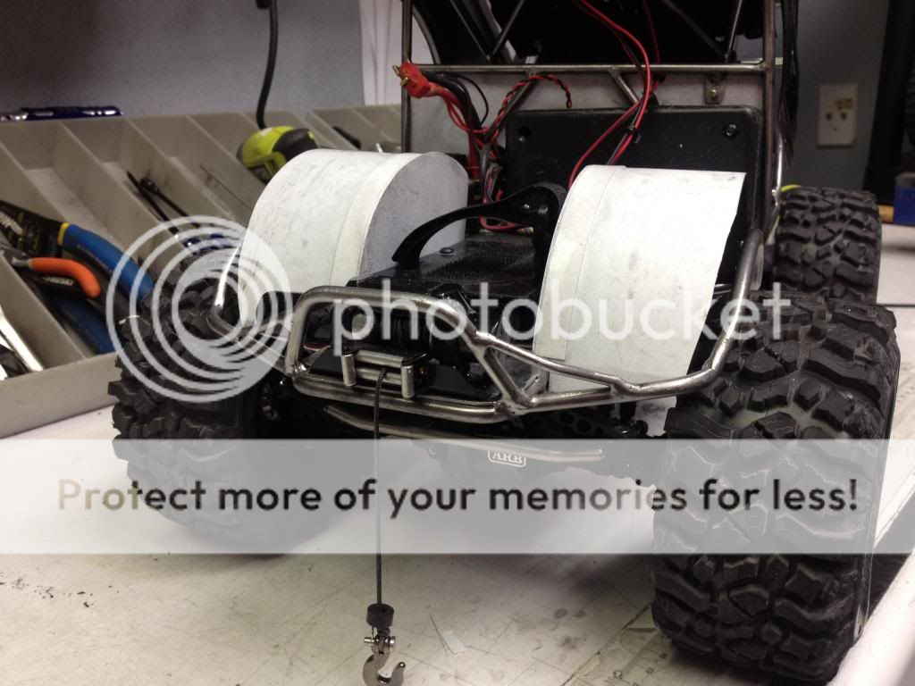

Whipped up some quick wheel wells to try the mud and dirt out.
I couldn't for the life of me get real boat sides to work so I resorted to just some covers that lay flat on the chassis rails but it also created an area for more lights :mrgreen:

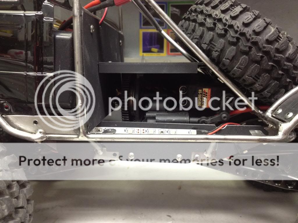

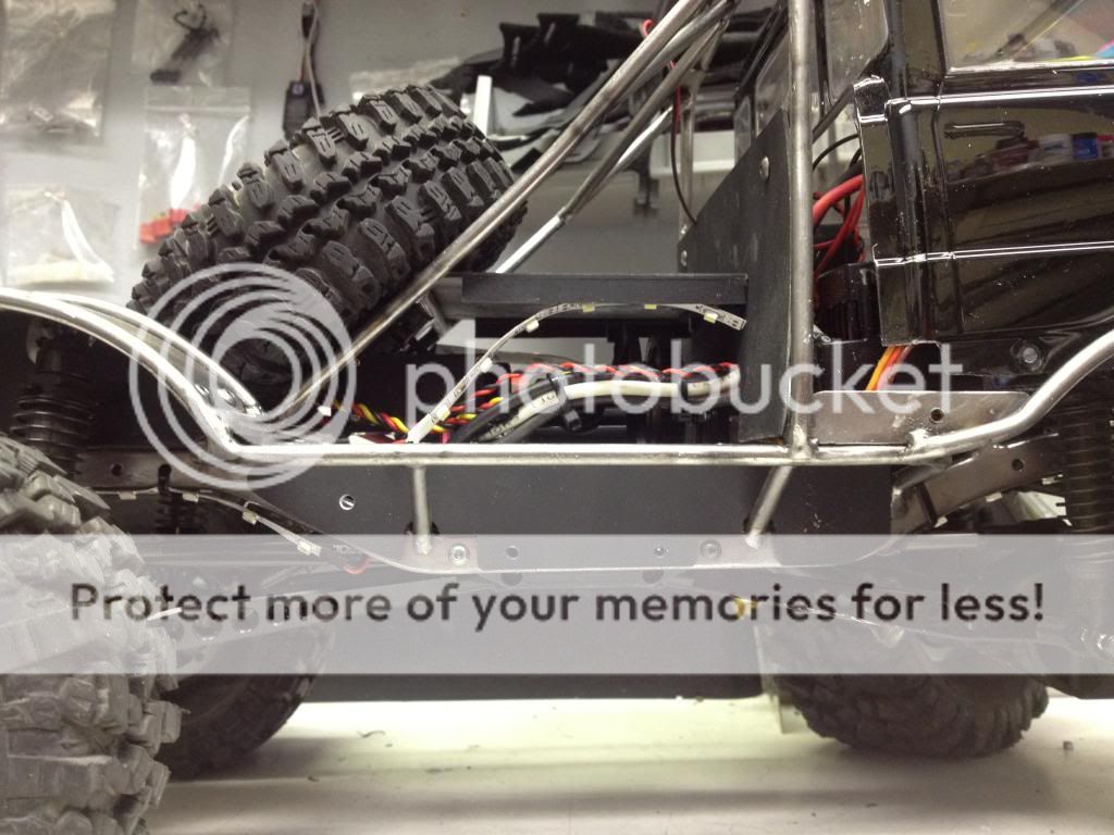

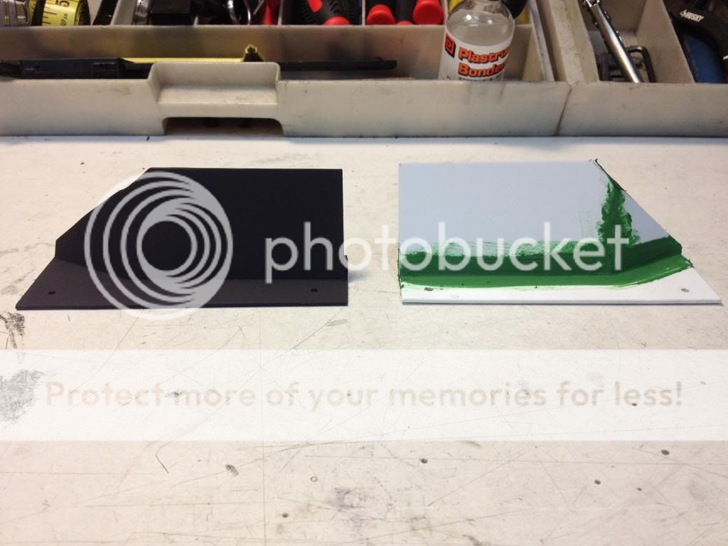

With the body being lexan and taking a little push, pull and squeeze to get it off and on the chassis I decided to use a simple interior, HPI Mini Trophy truck interior. Just 2 screws and some double sided tape to hold it in and allow for flex of the body.

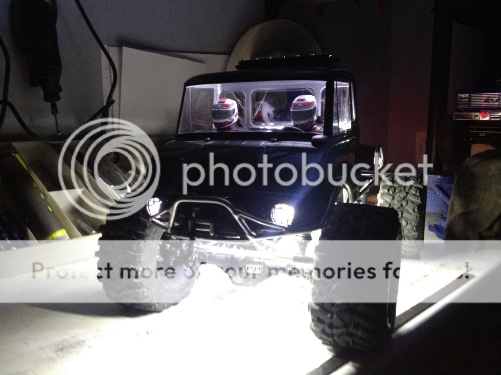

Did a quick light check then added some lights to the interior so its not too dark for our drivers :shock:
Started securing all the scale items. Heres the set-up for the sand ladders. Traxxas battery hold down plate pins, some people use them for the wraith hood and some elastic.
Drilled out the original holes for the elastic to fit.
Used some more pins to secure the tow rope and make for easy access

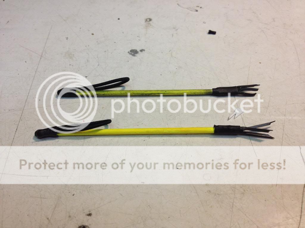

I did manage to come up with some spearfishing poles in about an hour, shesh!
All the specific fishing themed scale items mounted up "thumbsup"

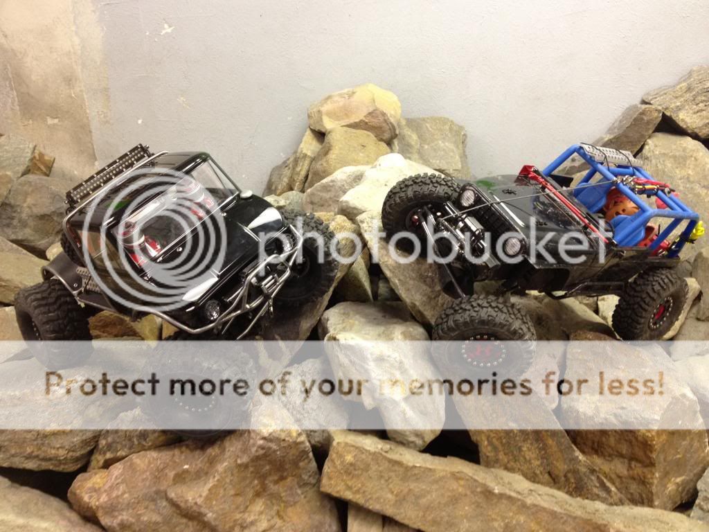

On the rocks with Tiff's TJ rig.
Thats what I got so far. Going to test and tune and hopefully make it through this weekends G6, thanks for looking

I started off with 3.5" big bores but then switched to 4" big bores for the bigger cut n shut 1.9s so when the regular 1.9's (slightly stretched on 1.5" wide 1.9 wheels) are mounted it throws off the look a bit but still performs well.
