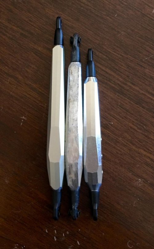

I didn't realize the Wraith length TA's were this much shorter...
I've already got some of it mocked up, I'll post some pics shortly.
The Wraith length TAs are not that much shorter. Those are a lot longer than Yeti/Bomber length. Here's Yeti/Bomber, Wraith, and Twin Hammers length. They may have sent you the wrong ones.
You're right Screamer, I just pulled out some stock plastics. I forgot, Metal Concepts TA's mount under their axle, not in front. Hence the added length.
I just measured eyelet to eyelet and they're just about 6 3/8". That supposedly is just about where they list their Yeti length arms at on their website.
Right, I forgot the ideal mounting location is under axle. Those Metal Concepts pieces sure are works of art, I can't wait to see this thing as a roller.
