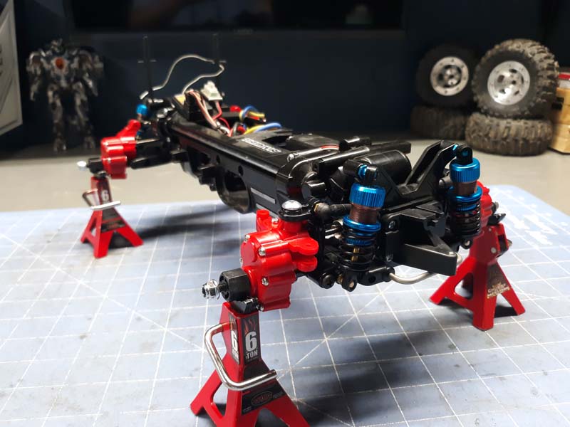

I've got one of the MF-01x Jimny's that now has the GF-01Tr portals on it, then took that GF-01 I sourced those from and built it with the WR-02 Wild Willy body on it, even was able to use the WR-02 kit to supply some of the parts needed to complete the GF-01 "non-Tr" conversion and plan on keeping it for the parts, since they share so many parts for being so different......I'm pretty sure there are parts on these that will fit my M-03 Mini Cooper too.......:shock:

Cool! Got any pics? Would love to see it. I'm tempted to buy the Tamiya MF-01X Beetle as well. Portals on it might be interesting.

Better yer, I have a whole thread8)
http://www.rccrawler.com/forum/non-crawler-rcs/622553-tamiya-mf-01x-revision.html
Still haven't posted completion pics yet (shooting those tomorrow), but I also have a thread on what I did with the Monster Beetle GF-01 that I used to kit bash the portals from and the Wild Willy parts to"thumbsup"
http://www.rccrawler.com/forum/non-...project-gf-01-wild-willy-2-a.html#post6066905
