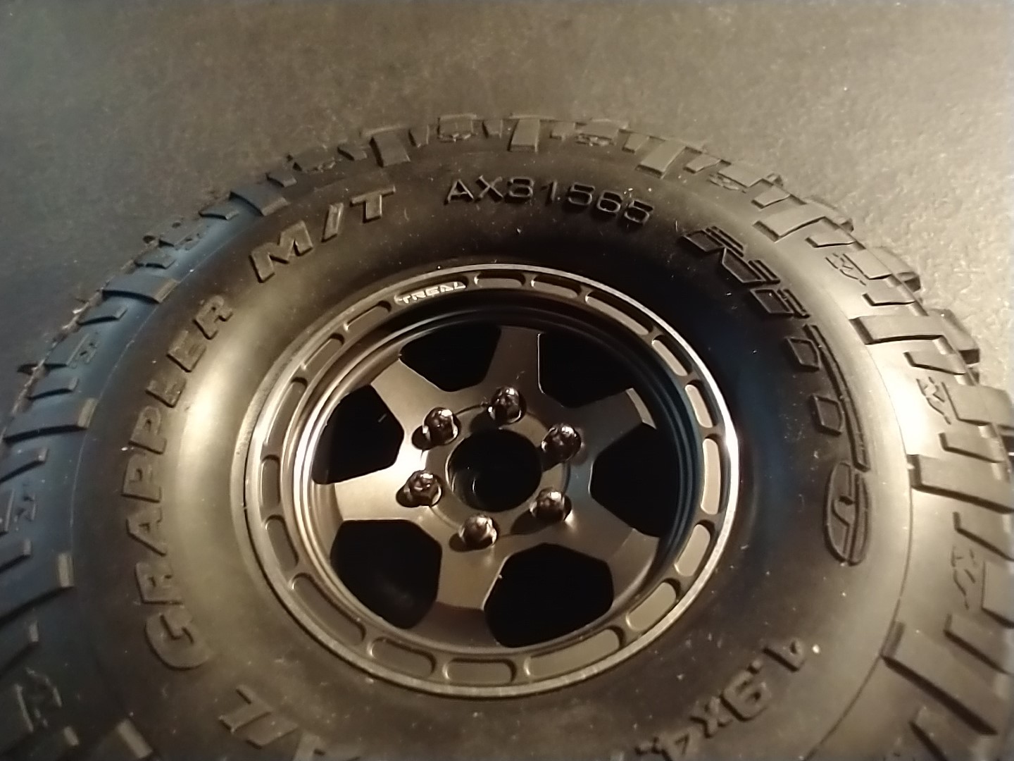

For the wheels I got some LockedUp RC 2.5mm acorn nuts and washers along with some 10mm SS grub screws from McMaster.
Also happened to have some 5mm SS acorn nuts I'd bought for something or other a few years ago so using those for wheel nuts.

Rolling stock:
Stock tires
Treal weighted wheels https://www.amazon.com/gp/product/B09X45FCQL
PowerHobby dual stage foams https://www.rpphobby.com/ProductDetails.asp?ProductCode=PHBPH475
LockedUp RC 2.5mm acorn nuts https://www.lockeduprc.com/M25-Acorn-Nuts-_p_411.html
LockedUp RC Precision Washers https://www.lockeduprc.com/Acorn-Nut-Precision-Washers-60_p_1645.html
Mcaster 2.5mm x 10mm SS grub screws https://www.mcmaster.com/catalog/129/3455/92605A073
Thought the acorn lug nuts would be a cool little touch. Assembled them with a touch of red ThreadLocker, although I should have gone with 12mm grubs, the 10mm will work fine. Used blue ThreadLocker for wheel assembly.
The dual stage foams for the life of me I wasn't able to get the tire assembled with the outer layer so figured I'd try it with just the inner layer. Punched small holes in the tires on the inner side sidewall just below the tread.
Sitting, tires look aired down, hopefully it works alright.

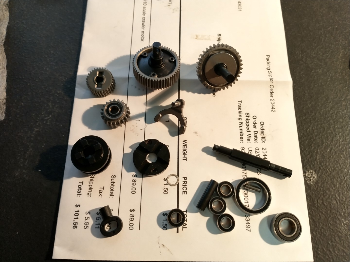

Motor/Trans:
Got the Treal alu trans today, fantastic looking piece, shame it gets hidden down in the belly.
https://www.amazon.com/dp/B0863Q6ZY4
I was planning on only disassembling the old trans tonight, cleaning the gears, and reassembling tomorrow.
However, there was barely any grease on the gears so I went ahead and finished it off.
Following the Capra kit directions for assembly, the only thing I did different was install the only shim in it on the opposite side of the gear indicated. Some have had an issue with this gear grinding into the case. It all spins nice and free so I don't expect any issues.
