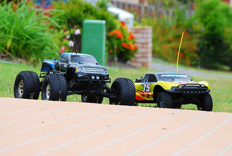

Oh, and Just a few pictures of my slash and a few with my fathers savage XL

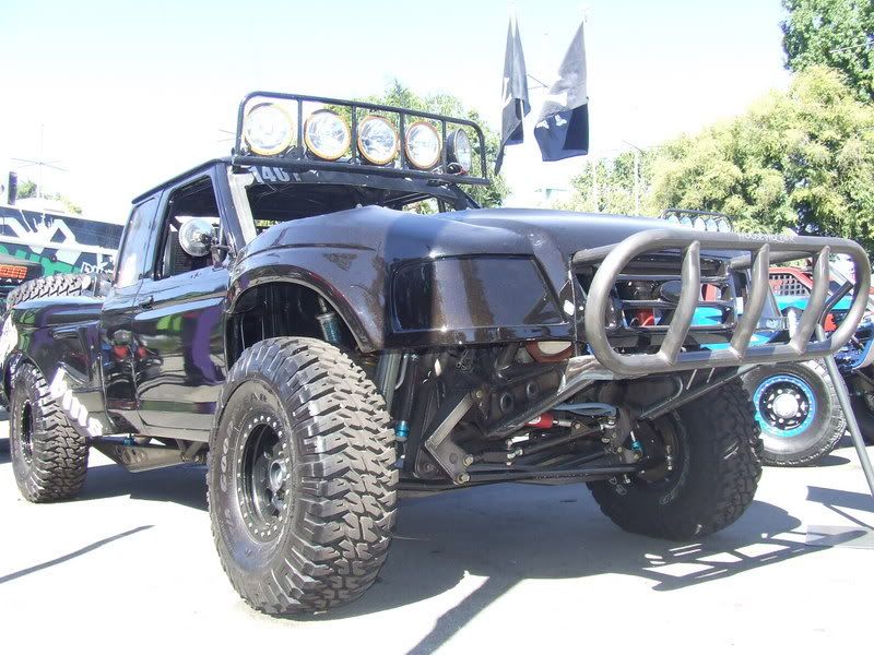

Im building my "Mini me" version of my truck soon. Heres some pics of my 1:1 Rig. Yes, same rig. Different paintjob/bumper/tires/rims... My trucks gone through alot of "Make overs"
