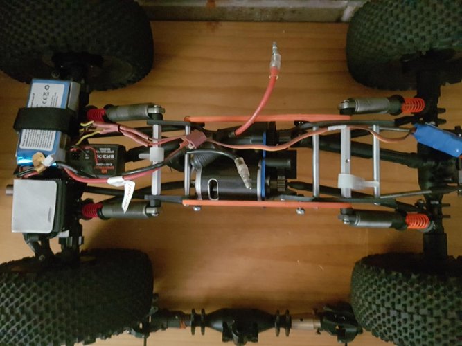

Hi,
Slowly been assembling my losi for a little while now and still have a few parts to go but here it is atm.
- 5d sucker punch chassis, losi boss claws, hd front worms, comp crawler shocks with mini t springs, axial wildboar axles, hitec 7955, custom links, bluemonket weights, etc.
Still need a new micro esc to get it testing and also want some new wheels and tyres to suit my tag axle that also needs to be finished.
Does anyone have any suggestions on this rig atm? just incase im too far off the mark with the build?

I have a Sucker Punch Losi CC. It works well. Yours is similar, and I expect you'll do fine. I use a lot of front weight in mine because our local comps have extreme climbs. And I use a 7950 servo which I think is higher torque than your 7955. Very powerful motor, Brood Axle Buster, and use the Holmes uncased micro ESC with 4S battery. It's pretty fast for a worm-geared Losi.

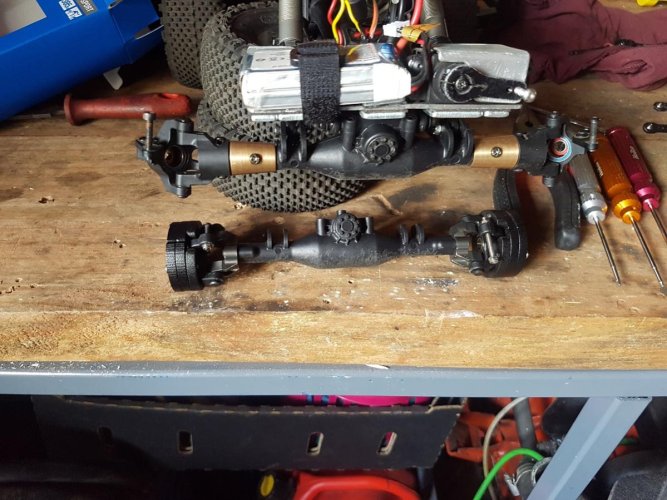

Where did you get the xr10 mod axle parts! I've been searching for them
149 r/c worx's Team Driver
I'd love to hear a positive answer on this but I think you're out of luck. He mentioned tag -- That's Team Anti Gravity and they made a small run of parts a couple years ago. So unless they make another run of parts...
I have a TAG axle and also scratch-built my own, pre-dating TAG. Machine a 2-step aluminum sleeve that slips over the Losi plastic housing with the bulges cut off. The outer part is machined for an OD that allows the Vanquish Wraith C-Hub to press fit on. Secure everything with 3mm screws. For an axle shaft, weld the outer part of an XR10 axle to the inner part of the Losi axle. Done. Works. Weak link is the Losi plastic housing. Have to replace it once in a while. They're cheap.
A fella here in Australia knocked up a limited run of them earlier this year, was just lucky to see it and get a set at the time.
I actually started putting it together properly today, just need to mod the axles. Then need to decide on what wheels i will run to suit, im thinking going the buggy rim route atm.

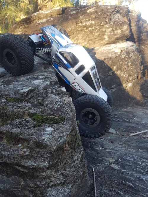

Finally got to take the crawler for a run, went so much better than expected. swapped back to losi white fronts, i think i need some more weight in the front but was fun.
Made all those climbs
