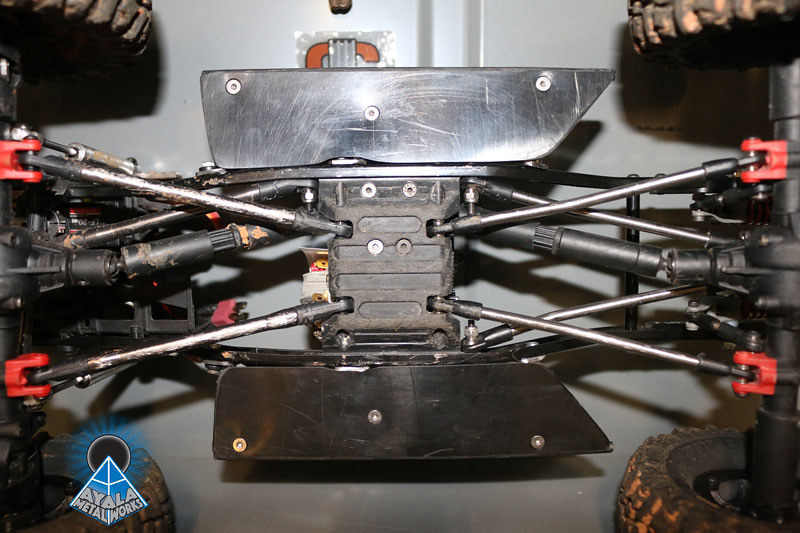

Pictures of when I built the front bumper and sliders.
As Jamie already posted about the sliders I will explain less and post more pics.
I built the sliders light weight, bolt on to chassis, and as a body mount.

1/16 delrin

You can see the tab with body bolted to it.

Sliders and bumper painted with grey steele it 3 coats 6 hour dry time between coats.
