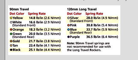

traxxas rustler spring rates
found these on traxxas website
