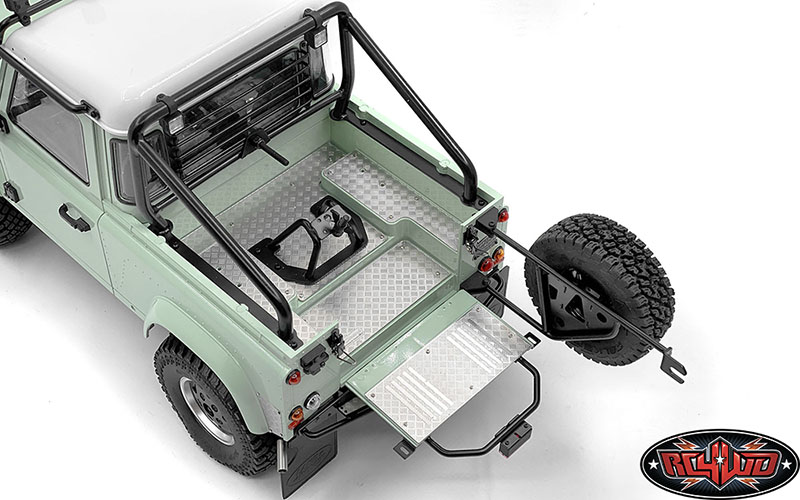

Here's a few options from RC4WD...
If you don't like the roll bar mount, you could fab something up from some sprue tree's and mount it to the back of the cab/bed wall. "thumbsup"
Making stuff from sprues sounds like a plan! Would just need to acquire a threaded bolt the same spec as used on the axles and somehow fix it on (maybe epoxy should do the trick) and tidy up the finished product.
Can't say that the roll cage appeals (it's not a standard Land Rover sort of thing, I'm going for a regular farm vehicle look).
The thickest sprue you can find will work best. I would make it so it's hidden by the tire when mounted. Screw it to the back wall with some M2 screws and nuts. Also, if you're cutting the cab to make the pickup, you could use the plastic from that to create some kind of mount instead of the sprue...it'll be hidden anyway.
Axles are standard M4, so a threaded 4mm screw and a ny-lock nut will hold the screw well enough and then, just a 4mm wing nut will hold the wheel on, making for easy removal. "thumbsup"
