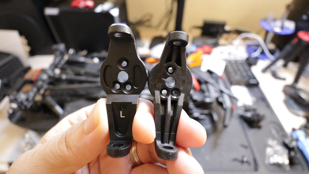

Here is the funny thing about the C-Hubs I got. If you take a close look they incorrectly labeled the Right C-Hub as the Left, and the Left C-Hub as the Right. The rear hubs and inner portal knuckles were fine, but the C-Hubs were reversed.
"Right" c-Hub and stock left c-hub

Here we go with a perfect matching pair of stock left C-Hub and the "Left" but marked "R" aftermarket C-Hub

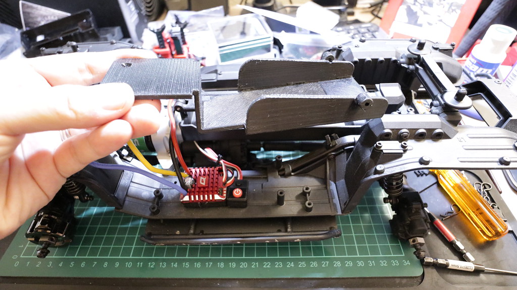

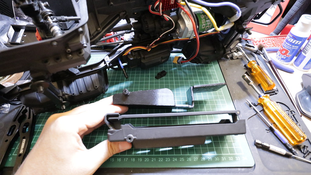

Here's another thing I updated. I found a LCG battery tray off of Thingiverse. Now that I have a 3D printer, I decided to give it a shot.
Here's the stock setup.
Here's the LCG battery tray.
Comparison of the two battery trays
LCG battery tray fitted and installed.

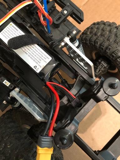

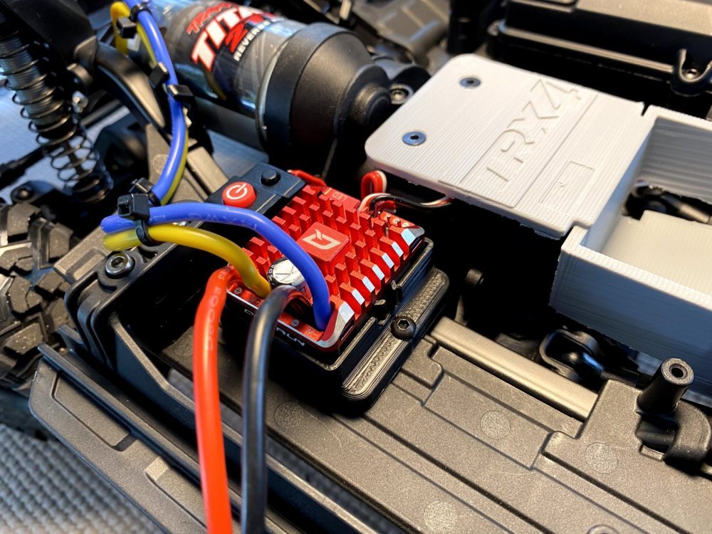

Have fun with the printer! I printed the same LCG tray and found that it hit the rear links at full compression, so I made a few tweaks in TinkerCAD and came up with this:
There is also a pretty slick HW1080 mount on Thingiverse as well, if you're looking for more things to print :)

Also regarding the low cg battery tray. I have the Bowhouse and had to cut it due to upper links contacting it. But I am also running the IERC rear shock towers like you are on the Enduro. Your video is where I got that idea.
I put the bowhouse in right away and don’t recall if there was contact before the new shock towers. But definitely once I tilted the shocks forward.
I run smaller battery packs (2200/1500) so I trimmed the tray to the end of the 2200 and it works better.
