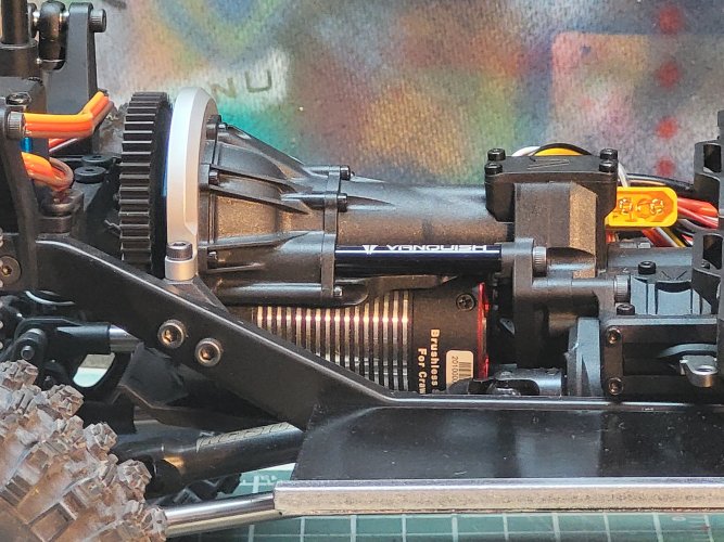

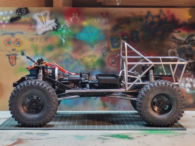

I while back i built up the chassis from my straight axle Phoenix kit. It's been collecting dust on the shelf so I figured I would do a Yota thing with it.
The Chassis had been built up with a HW Fusion Pro 2300kv combo. I added the aluminum standoffs and motor plate into the build.
The OD is locked in at its lesser setting(6% IIRC). While the OD is locked in, I plan to run the Dig unit. It is definitely my favorite feature on the Twin Trans.

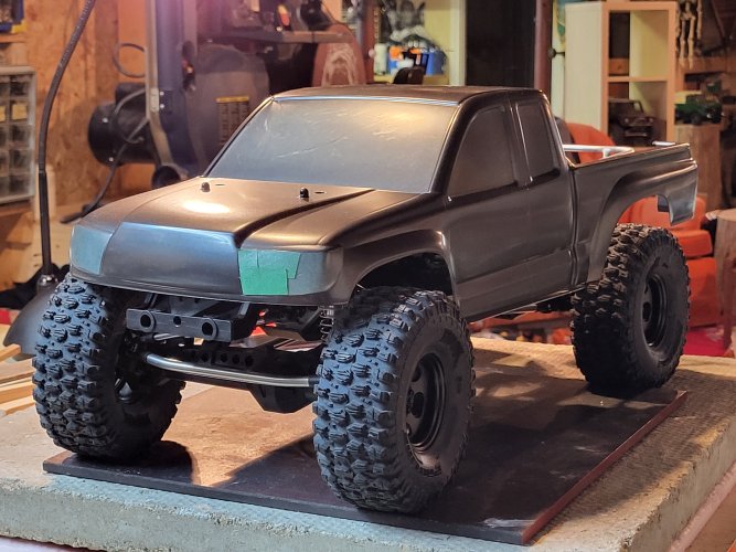

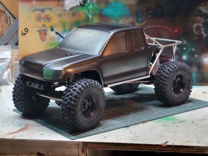

The body of choice for this is the Axial Basecamp which is obviously an 05-11 2nd gen Tacoma. I began by painting the inside of the body Gunmetal.
As I mentioned earlier this is not gonna be a grocery getter.

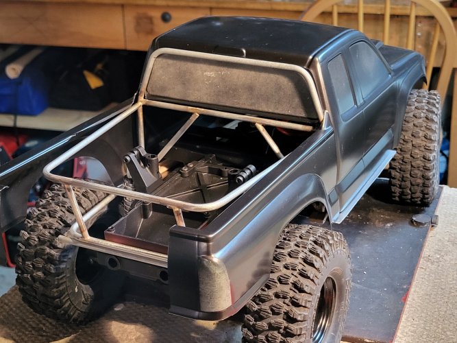

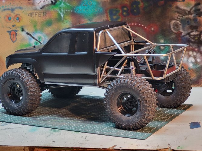

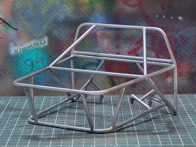

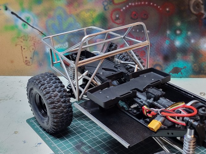

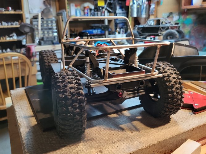

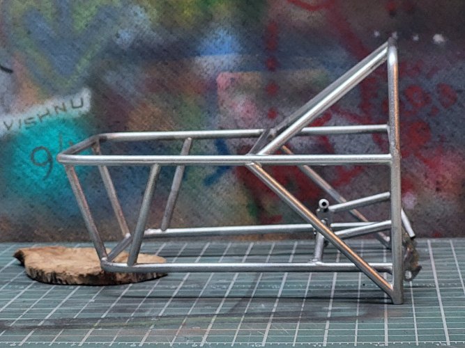

I got to work butchering the body and soldering up some semblance of a bed cage
Coming along nicely...
Pics of cage all painted up

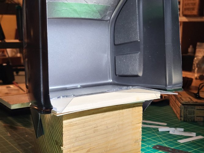

Needed to do something about the cab back because it was wide open. Could not close it right off because the DIG servo happens to sit in line with back of cab(hence why the Phoenix body is designed with a bump out at the back.
Used some E6000 to attached some poly carb pieces
Looks legit. You always "whip up" some of the coolest rigs!

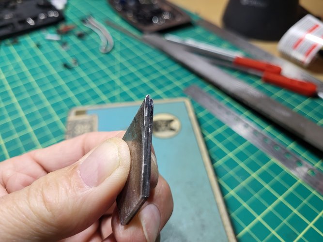

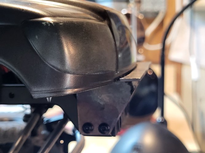

I finding making front bumpers to be a complete bitch. I am nearly never happy with my front bumpers and some days it really burns my ass....but here we go. I have my Preparation H handy

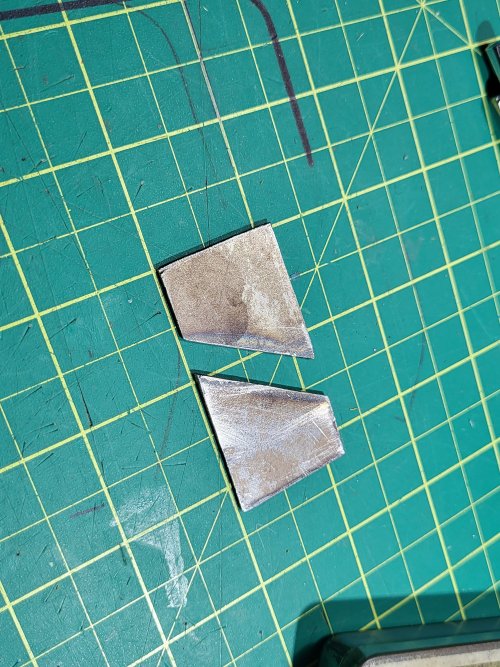

Mounting Tabs
Making the mounts identical is imperative and so challenging with nothing but basic hand tools. The smallest imperfection appears glaring once it's mounted. I find it can be crazy making. Also, if the body is not sitting perfectly straight, i swear it's ways the bumper that looks crooked
I may yet add a small squares off stinger

I always wondered how much more the Basecamp headlights would look like that gen Tacoma if you painted the bottom line of the headlights to appear to have the same shape (a little angled point).
Following. Definitely a great start!
You have a good eye for detail. The Basecamp would no definitely be more accurate with that detail.
I printed the headlight buckets that James Knight designed for the Metric Body. I imagine they will fit but haven't test fitted them yet

My tube work is coming along. Not sure I am the most efficient in my process but I get the job done.
incredible job on the cage, looks legit AF. I also love the little detail with the body trimming at the rear, matching the angle of the cut bed to the angle of the frame support looks professionally done. the 1:1 is super cool too :)
Awesome, thanks for noticing the detail. I think these little things are actually what set the work off. Symmetry, continuity etc. I have made some pretty wonky cages in past from not paying attention to detail.
The thing I find with my builds is that I am continuing to refine my process and get better in all the things I attempt. Be that cage work or painting. I have been painting a lot of Patina since I started attempting them. It amazes me how many different techniques one can use and still get a realistic result. Again here I am attempting a Patina on the hood and roof. Here is what I got

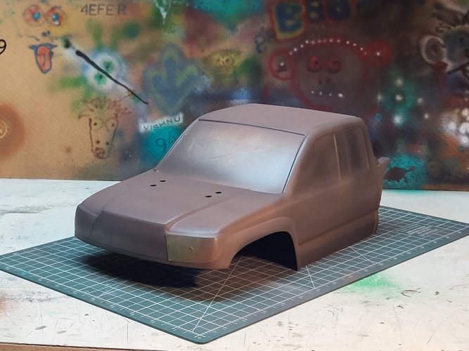

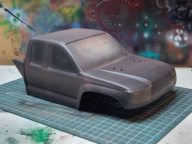

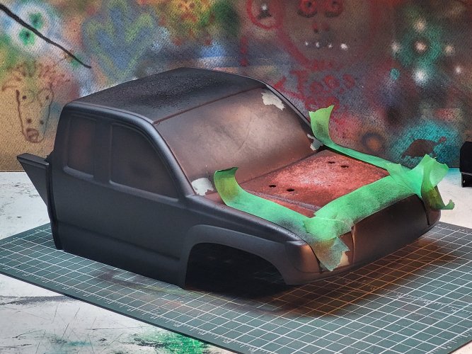

First a light rust/brown
Salt and a more reddish rust while taping off the hood . Also Painted another coat of black over the light brown rust so that it.can weather thru
The result
