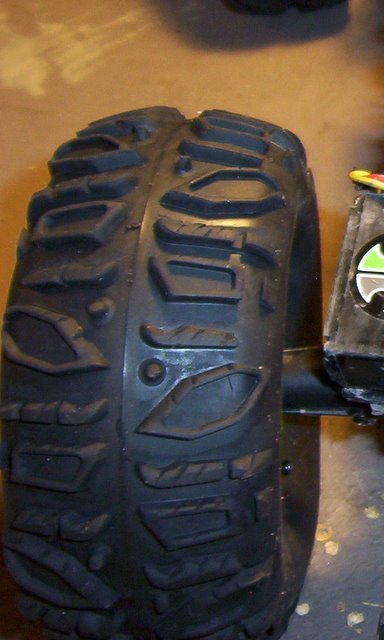

I used a dremel with multiple cutting disc it gives it the cleanest look and it makes a world of difference on the rocks. Makes the tires fold in more."thumbsup"
Took a knife to my hammers and it helped a ton!!!! "thumbsup"
just cut the outside lugs with a sharp knife......

Did my M2 Hammers right out of the box too. From the car winter snow tires I deal with all the time, siping helps huge on slippery surfaces. Not sure if it has helped on my dry, grippy rock however cause I have no stock testing under my belt. <shrug> Got Rovers on the way anyway.
just a bit of a side note. you will see more gains from sipeing if you go across the tire rather then with the direction of rotation or 45* too it. as far as forward movment goes or if u want more side hill grip then make your cuts in the direction the tire moves..
i fnd the best is 45* but alternate direction of your cuts on every lug,
smart guy! its like a dual purpose sipe! and it does work quite nice the softer the tire the less rubber you need to take out
