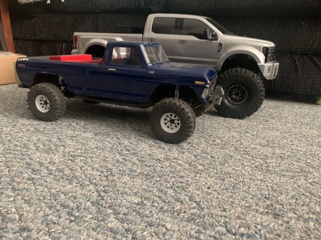

They were a little wide for the tires, so I shaved them down a little and they fit perfect, as well as stopped the tires from smashing down so far.
Now that summer is here again, I need to put these back on and try them outside a bit.
There are some pictures here http://www.rccrawler.com/forum/redcat-crawlers/613807-new-gen8-axe-edition-choices-choices-choices-4.html
Unfortunately, the Redcat Gen8 portal axles are just too wide to get a decent scale look out of this truck body. I will likely end up using these on a different build down the road, as I do want to build something a bit more scale’ish.
I’ve got the suspension lowered as much as possible and the body is as low as I can get it without major modifications, but that does not fix the axle width issue.
