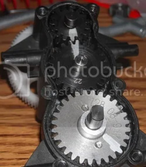

No offense taken, you just didnt go to the same schoolI did. I don't 3d print for anything but a prototype. I went to school for industrial design, and would take it to my old shop and have a 7 axis cnc shit it out in aluminum or steel after the initial trial(s). Both 3d printers I have are now "old" by today's standards.
However, the Ender 3Pro will print a polymer filled nylon.
It could be "fashioned" similar to an old brat/frog transmission. 2 machined side plates for the flanged bearings and a 3d printed spacer to screw the 2 plates to on the outside. Make sense? The gears are flat! No sideways force. You can make the bearing pockets as big as you want on the sideplates. You just have to buy big bearings.
The 3d printed spacer, would essentially encapsulate the gears, and keep dirt out. Not much else of a purpose. Think of a clod gear case, minus the axle tubes, all in Mod1 and made smaller essentially

The sideplates can be "machined" , ie drilled with a drill press. Same with the bearing pockets. Just takes patience and some sharp drill bits, a punch and a marker/blue. Work your way up.
Take 2 pieces of aluminum and clamp them together to get all the holes to match up. Drill your perimeter holes on the outside of the gears for the case to hold it together.

As for drilling the side plates, beside clamping them together you can also 3d print a drill jig to get the bearing center to center correct. Biggest problem I'd have is getting those spaced dead nuts. Even with center punches, etc on a drill press.
Center punch, ALWAYS ! and work your way up in drill bit size. By .5mm if needed!
Also, If you clamp your workpieces to the drill press surface, you will have very minimal play/unevenness between the two workpieces themselves
Stub drill bits are key, as well as a center drill bit. Those are great for little things like this.
