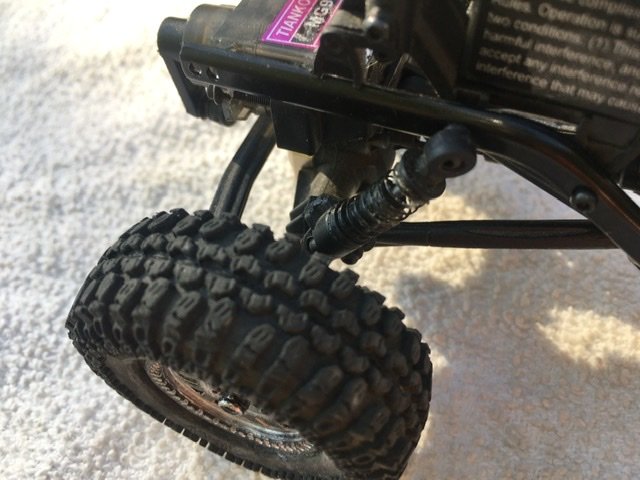

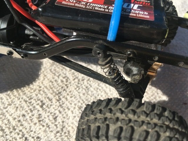

I use Squirt wax bicycle chain lube inside for damping, and run the shocks upside down to help retain the lube. What leaks out is fairly clean and dry.
I also mount them to the frame rails to soften the suspension.

That's a clever idea mounting the shocks upside down so they don't leak as bad.
