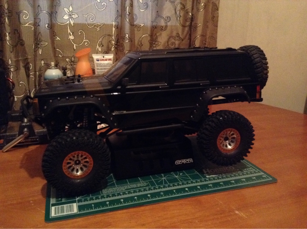

I kept the length of the links as it came with the scx10 wrangler. It's slightly longer but I made up the difference using fender flares. The rear tire is centered on the flares but the front is pushed forward a little. I'm fine with the way it came out. I have no issues with it. I'll post a pic once I get better wifi.
The flares really open up the wheel wells and give you a little leway with the wheel base. The truck looks great! I on the other hand made links (all 8 ) installed the body at dingo wheelbase and when the wife drove it, she hated it! So she's back to stock honcho w/b and body :roll:
