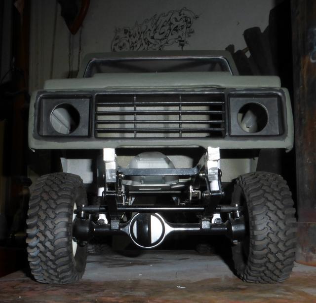

The way the stock front frame horns curved downward was not going to
work with the bumper so they got modified..8)
Started by tracing out the frame rail and figuring where to cut.
Made some straight extensions and drop hangers.
Reassembled everything,now the bumper will tuck up against the grill.
(yes the over spray on grill will be fixed..:) )
