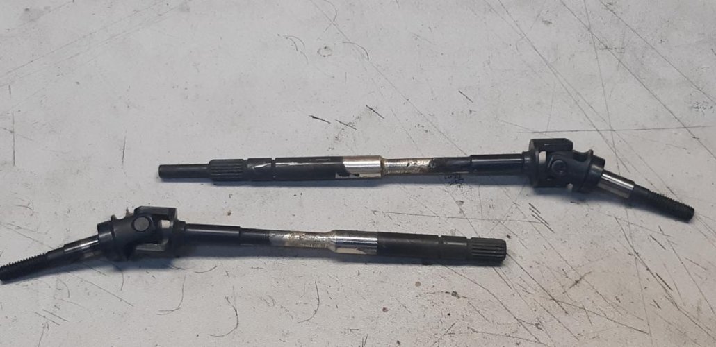

Found a motor to bastardize. Lightly used Team Orion Revolution V2 endbell motor. I paired it with a Holmes Hobbies 27T handwound armature and also did the mod shown above here.

That LNC tranny mod is probably the best mod for the losi. It doubles the speed of the truck and with the hot racing gears you just press them apart. So to reverse it all you have to do is press them back together and flip it over
