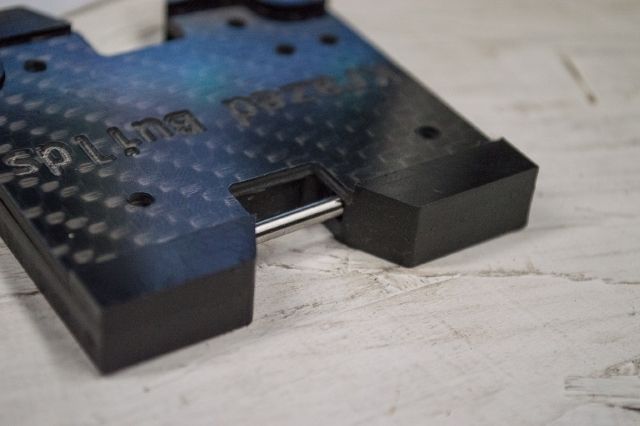

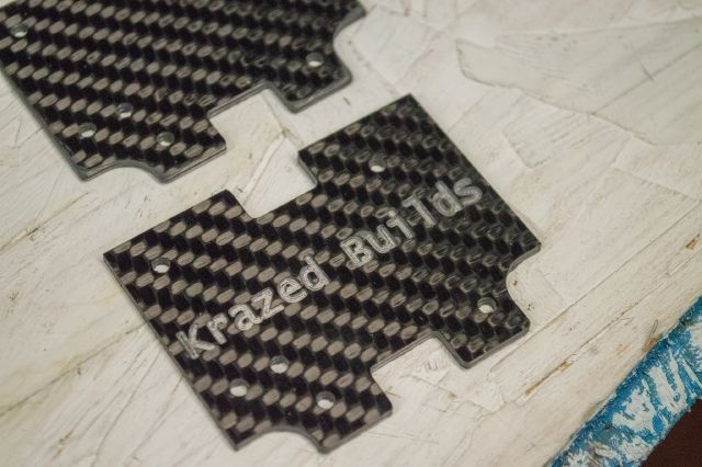

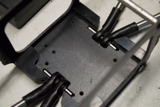

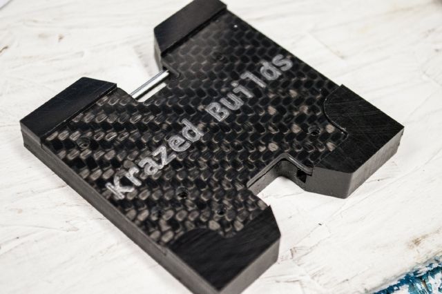

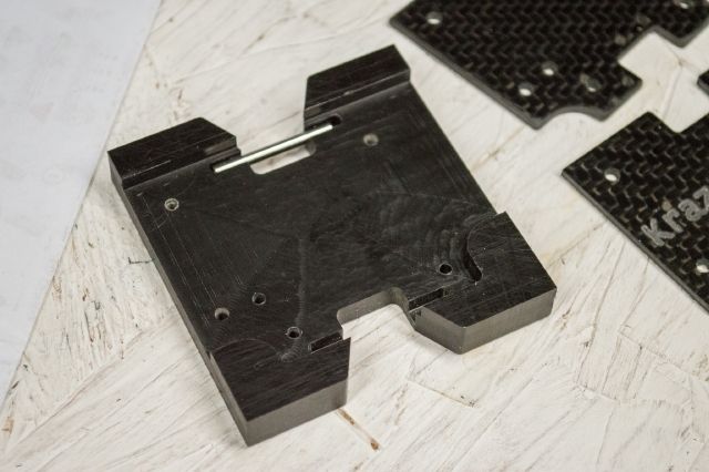

In between some orders and inventory runs I managed to get a skid cut and pocket milled. Its actually smooooth to the feel even seeing the tool marks. Flat tip 2 flute end mill with a .02 step over ... cosmetically I think a .05 step over will get rid of the lines better but good for mine and trials.
And some CF (of course) but for what?

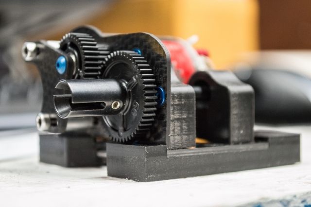

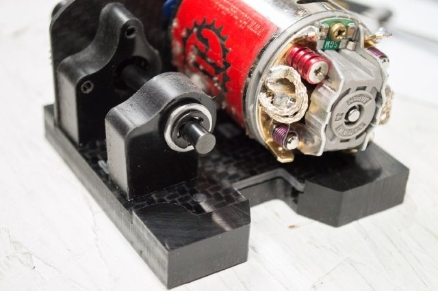

The idea is to pinch the lower link pins inplace and not have to use the Losi pieces or change the triangulation from Losi.

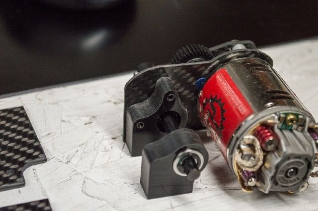

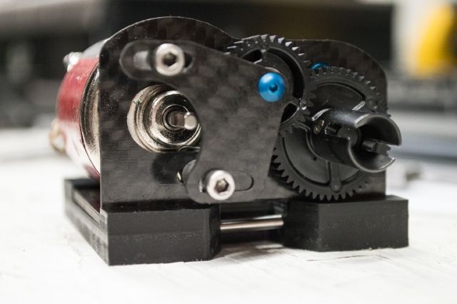

And how do we hold the tranny in place? With some delrin mounts of course.

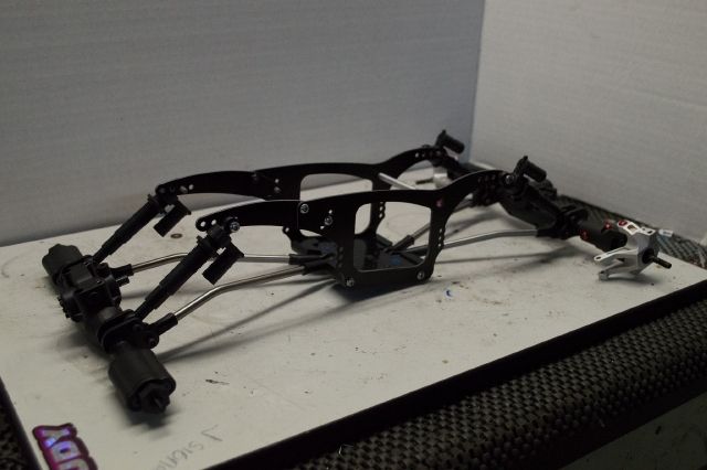

And mocked together ........
And well thats it for now ........ next stage is getting the other ideas out of my head and into this. But that has to wait for after Krazed parts. :ror:

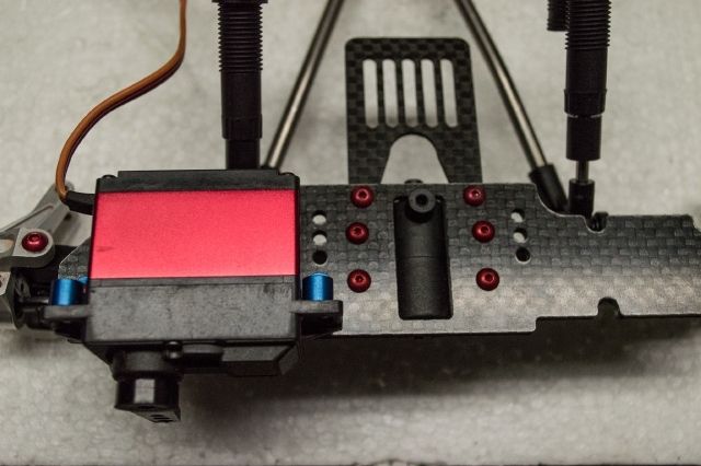

Got a little work done on the fun box and some stuff done to the Losi ......

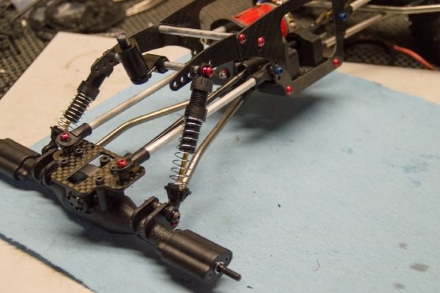

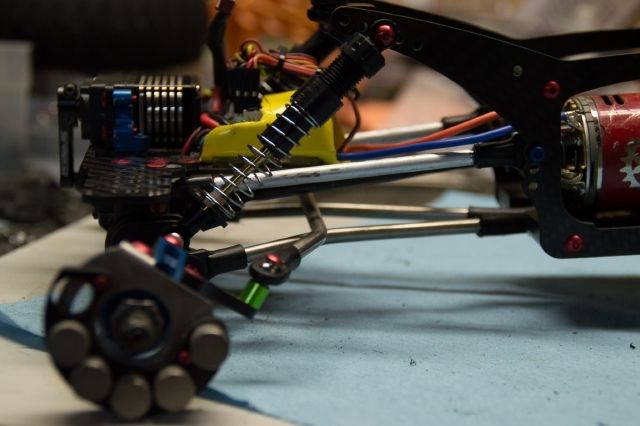

Little shot showing the lower links inplace
And some of the chassis setup ..... Ill be honest I dont liek the front shock angle so thats gonna be worked on before I commit to any CF material. The rear shocks are on a similar Losi style adjustment. Two screws hold each arm and allow you to rotate them up or down about .125 to alter belly and shock angles.

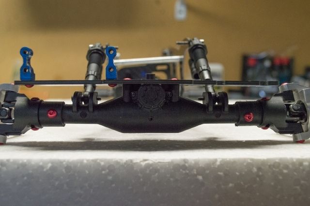

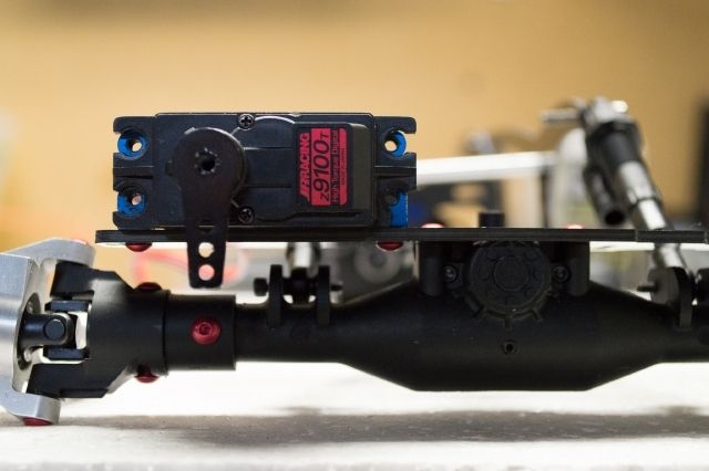

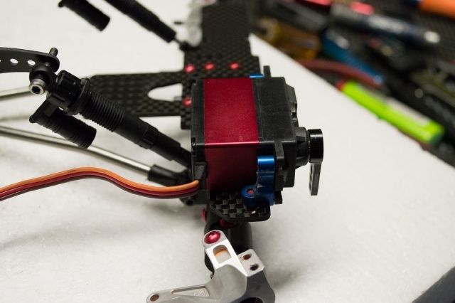

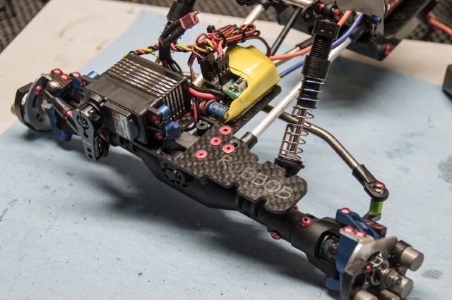

So after some talks with Jens on the front axle plate I made some changes to it. Noticing I couldnt get all my steering and the battery was stuffed in the wheel I brought the servo and battery in a bit more.
So we went from this .... notice the top screws and servo location ....
To this and counter sunk screws
There is a v3 coming though that moves the servo back and over to center a bit more plus the battery over as well. This should clear me up for max throw.

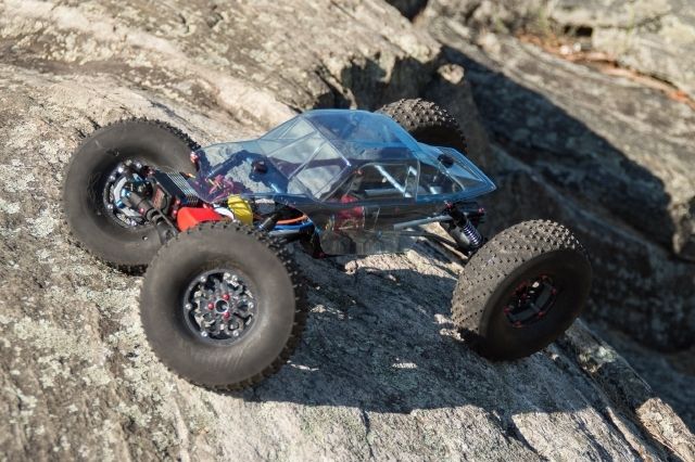

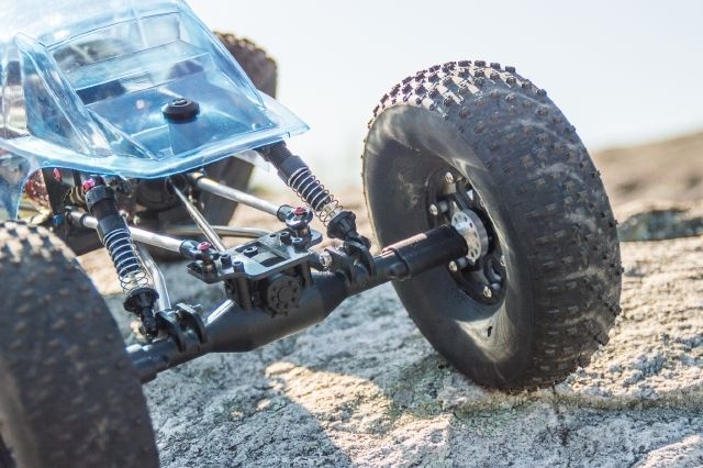

So heres my infamous paint job that brought me luck with my old pro rig .... and some shots of the under carriage.
My rendition of BTA for the Losi
And the rear side

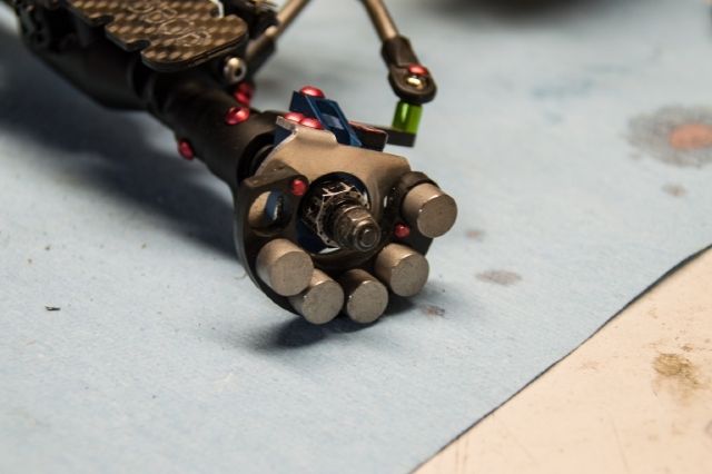

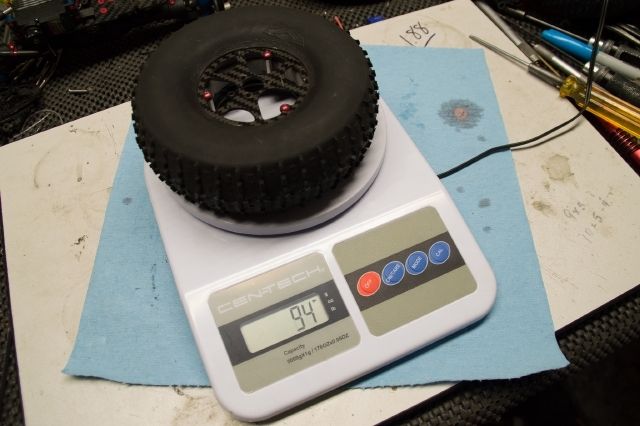

Plus a shot of our 1100's weight hangers giving us over 70grams per side available.
C-Class with Purpmart Voodoos and Crawler Innovation foams

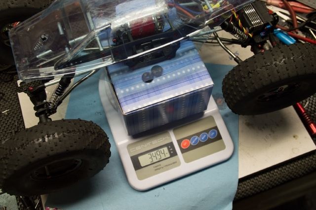

And here she is tipping the scale RTR with a 4S on her ....... This thing needs a diet still ;-)
More to come later on ...... got some skinny things coming in for a change. Got a couple packs of practice and was pretty impressed with its first outing. Some more test n tune for her and Im sure shes gonna be a front runner with a real driver behind her :mrgreen:.
