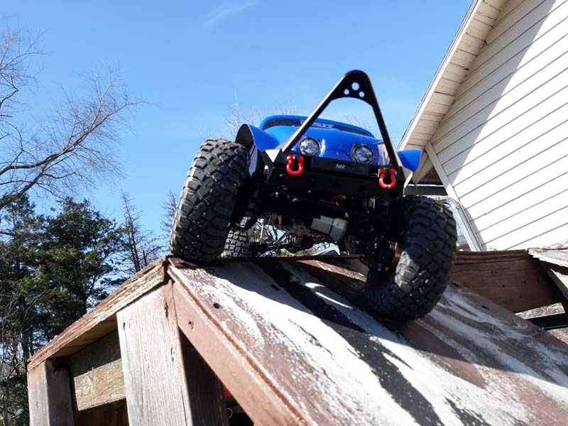

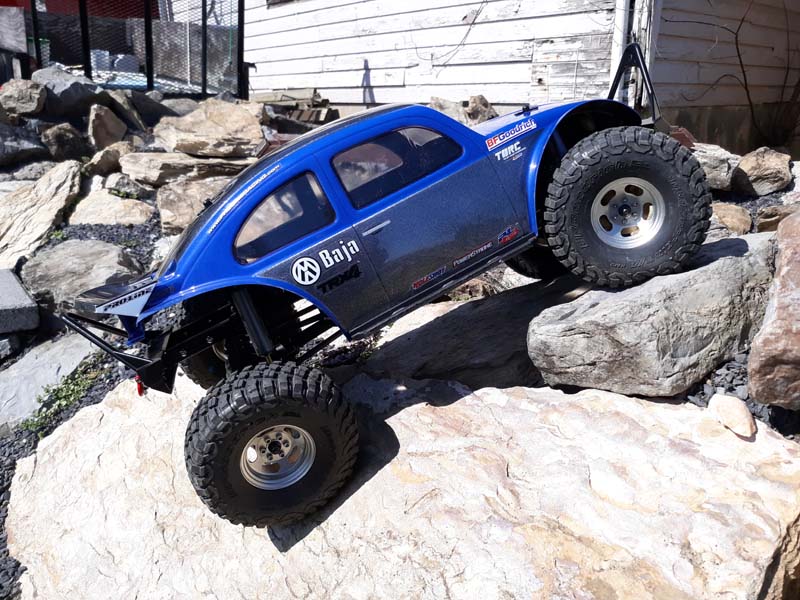

Finally got this build out for a test. All I can say is wow! Sometimes you get a fresh build off the bench and sucks (my SCX10 for example was miles off) and sometimes it performs fantastic - this was definitely the latter.
These tires are fantastic, wow. Grip for days! A heavy truck helps for sure but so far I'm super impressed with the Predator compound.
The shocks are set in semi droop, so the chassis sits somewhat low. Basically all the lower links are level. The body is light as heck, so the weight is down pretty low, though I still have plenty of clearance with the portals. About as good a stance as it gets with the TRX platform. It's way stable, miles away from my Defender. Nothing on my course even made it work hard...can't wait to get this out on the wild.
The new Crawlmaster "red label" motors are incredible. Super smooth and loads of power. Definitely my new go to motor! I do need to bump the gearing, it was way slow...9/54 is perfect for 3S though I still just run 2S.
