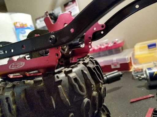

Anyone ever run a slightly dropped tranny and motor? Try to fit the losi trans best on that 10.2 frame.
