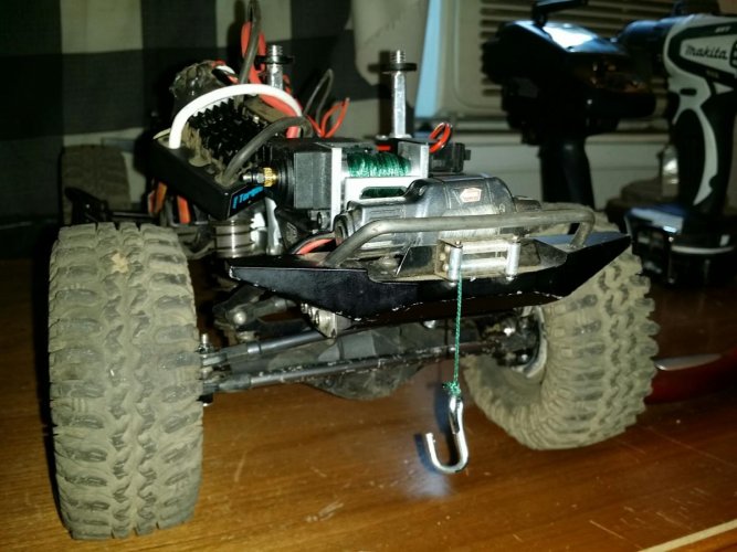

Two KMS winches and two HeyOk 4 amp relay controllers. Works killer"thumbsup"

Would like to have those servo winches. But that's not in my budget. I have the warn wireless winch and it does what I need it to. I have the same rear bumper as you is why I want to do the duel warn winches. Just not sure what heyok controller to get for them.
