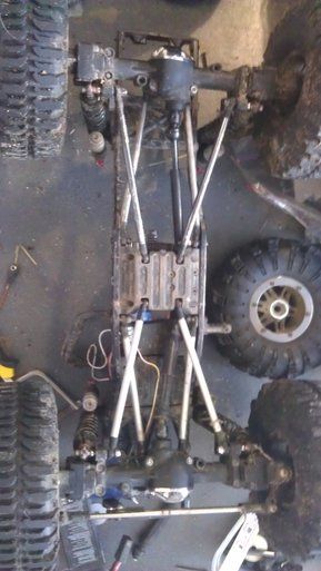

here's a couple of body off pics, I know they aren't great, let me know if you wanna see anything else
I have always wanted to see an SCX10 with R1 axles and now this makes me want to convert one of my rigs over! Looks like a beast with those boggers and it looks like a wicked lifted jeep
