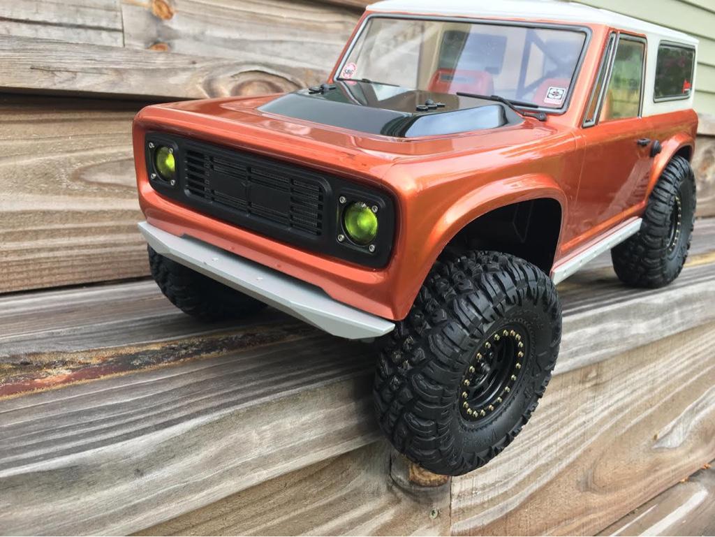

PS55 then shoot any TS over, this one is going on two years now
After and before
