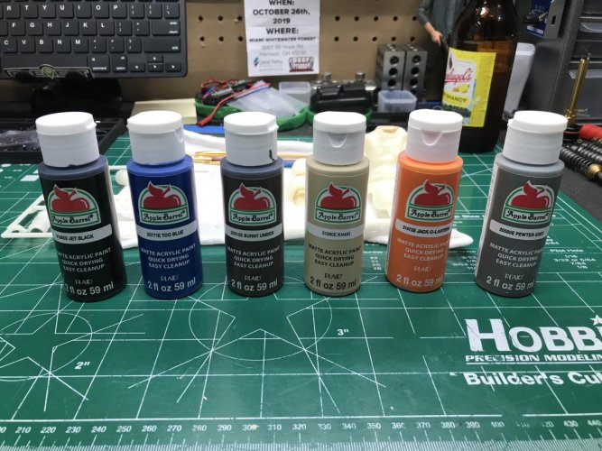

What do you use to paint lexan interiors tan? I don't see any polycarbonate spray paints available in tan.
I was figuring on painting the top since it won't be touched by anything, and it would reduce the sheen.
Thank you! I will try those!
Your welcome!
Just an FYI, these paints are for plastics. They probably won’t stick well to lexan.
