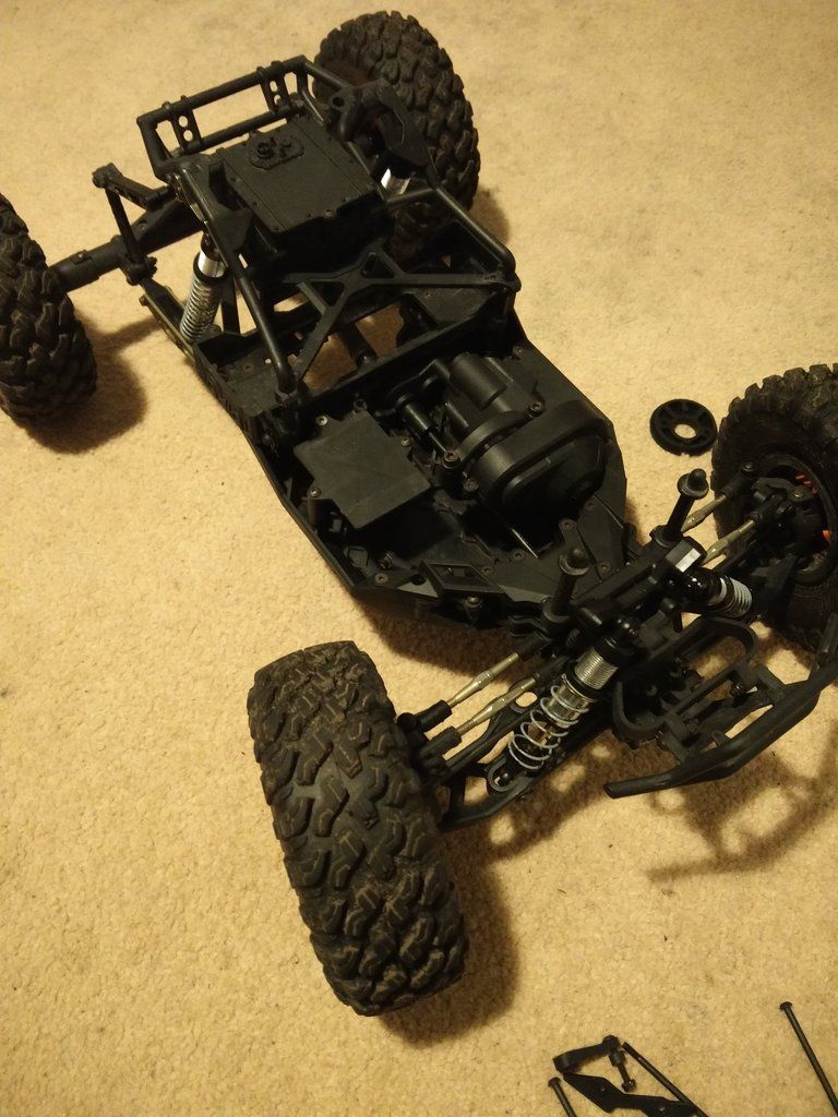

Firstly I started stripping it all down, cleaning and replacing worn or seized parts. Turns out the slipper pads were installed incorrectly, and the slipper plates had fused with the top shaft, so new top shaft and slipper plates were needed (dremmel to the rescue).
Most bearings needed replacing which is fairly normal, the front hinge pins were also quite badly bent, also the front camber links were not equal lengths.

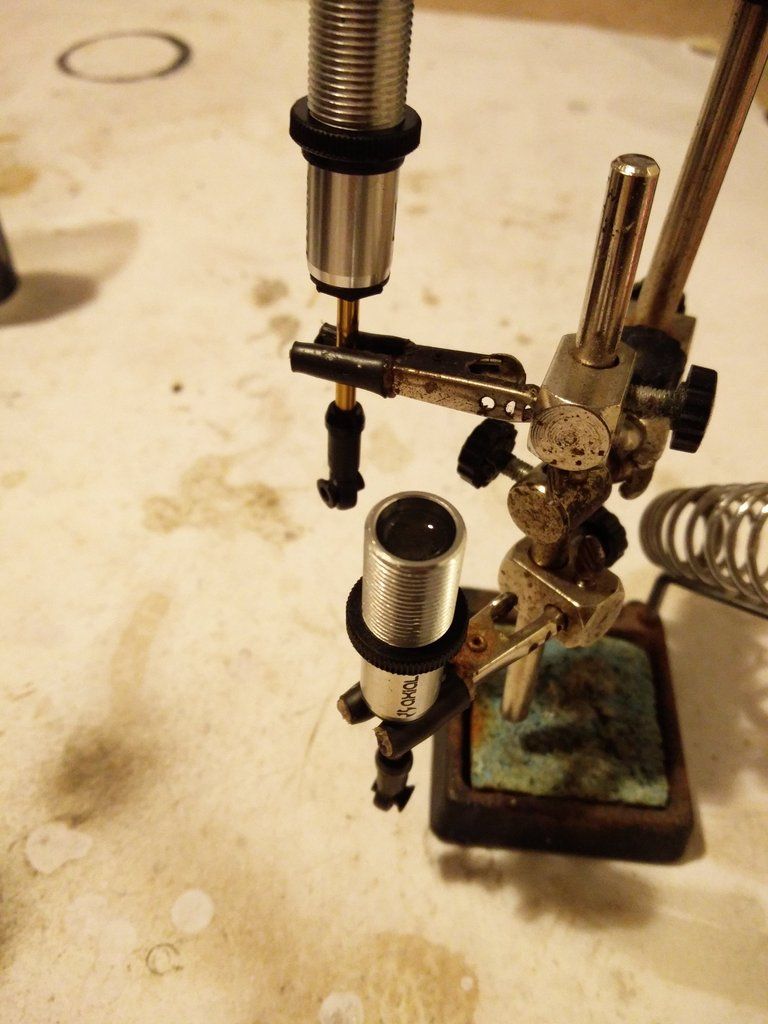

I'm still waiting for the top shaft and plates to arrive, and new o-rings to try and build leak free axial shocks (don't laugh).
The front diff was filled with fresh 7k oil, greased and put back in, the rear was cleaned, shimmed and put back in. I have shimmed away play in the pinion gear so it cannot move forwards or backwards which helps them rotate better and not change mesh under acceleration.

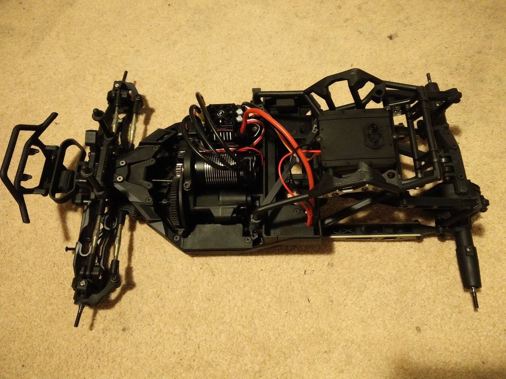

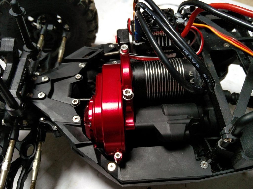

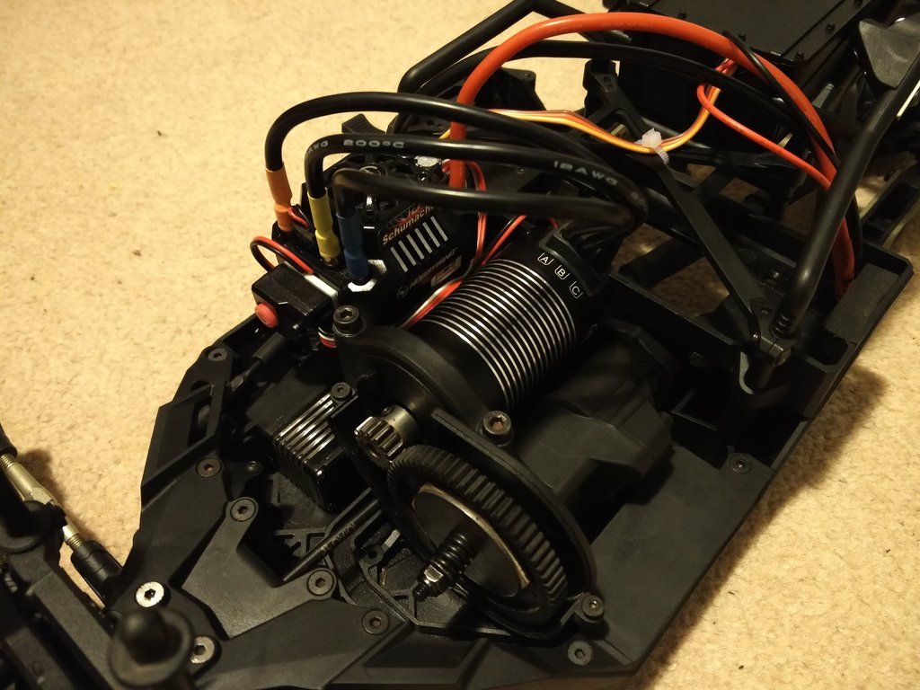

Electrics wise it'll be running a Hobbywing Max10 SCT ESC, Hobbywing 3660 4000kv motor, Castle BEC, Hitec 7950th servo, Spekky DX4C Tx.
Vanquish bell crank will be fitted with the relevant rack, going to stick with 2s lipo as that's what I currently have, closed cell foam for the wheels (so they don't fold when cornering, or balloon), Robinson Racing Gen3 slipper and spur, SSD Trailing arms, Incision spool and upper rear links and cheap method copy beadlocks.
This Yeti will be a basher, not a crawler, as much as I would have liked a sensored setup, I think this sensorless setup will be fine.

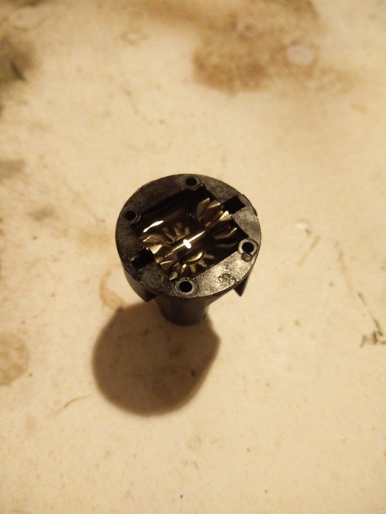

Clean diff (was grey before)

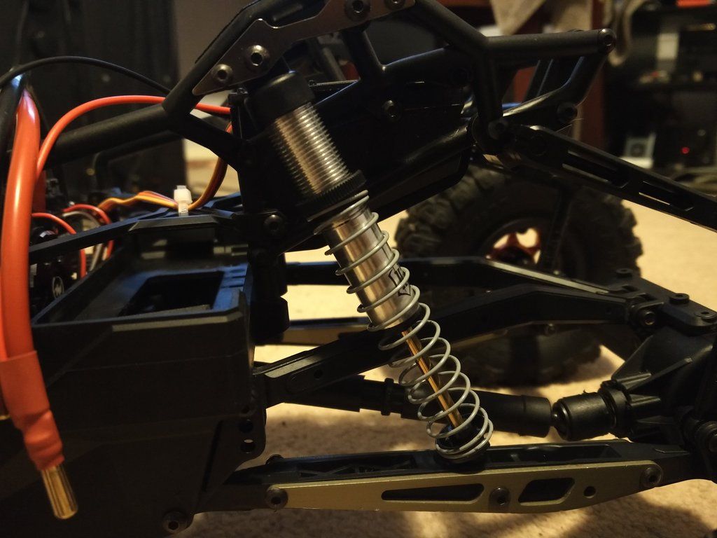

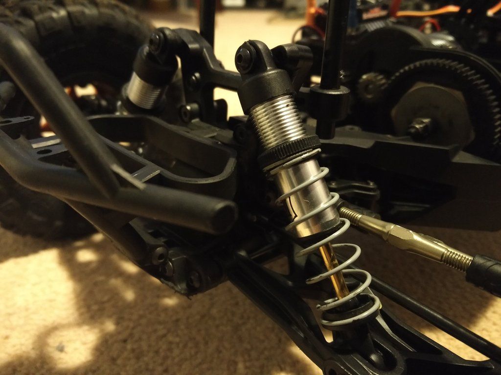

Got it finished today, used 3 HPI o-rings in each shock (o-ring replacing the spacer), all built with green slime, 30wt rear, 40wt front.
Gave it some negative camber, and a little toe out.

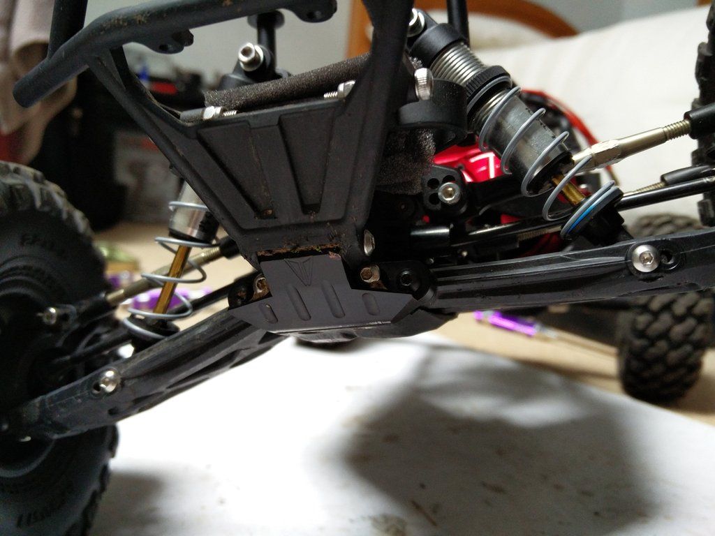

Beefy: incision spool and upper arms, VP steering rack (no more sloppy steering), SSD trailing arms, Robinson spur.
Still waiting for pinions to arrive, and wheels. The plastic motor mount doesn't allow as fine adjustment of the mesh as metal ones do, so that's on the list to get, the plastic one also flexes quite a bit.

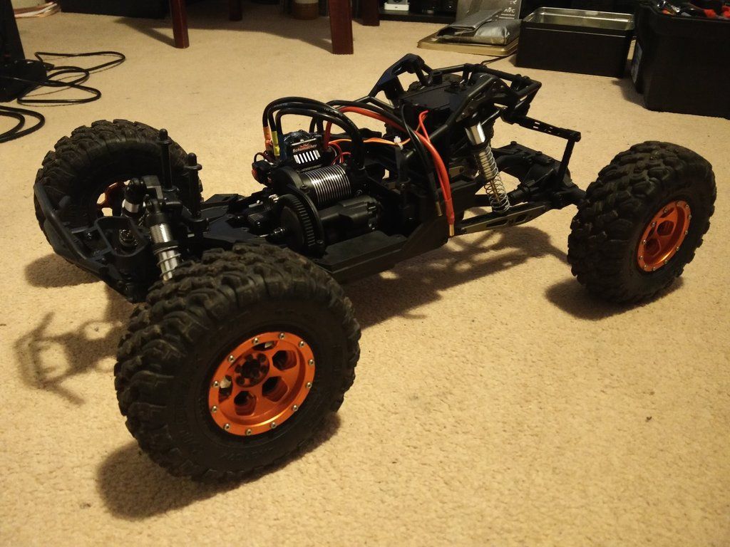

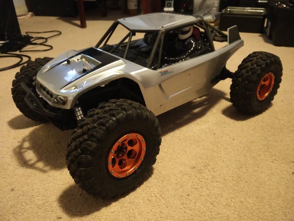

Vanquish method chinese copy wheels fitted, accidentally ordered the narrow ones, so they were a pain to fit but look good. If I want to used the closed cell foams I have with other tyres I will need the wider ones.

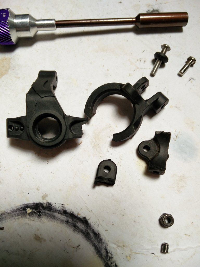

Well it was bound to happen, on it's maiden voyage it was destined to break. Highlighted weak parts at least, and also I had spares to repair it sitting in my spares box. This thing is awesome though. Kind of what I was looking for, relatively fast but can get up fairly difficult inclines and just flies over rough ground.
Also it broke from doing a small jump, nose diving and cartwheeling... not a surprise really. Had to tighten the slipper clutch down too as it was slipping quite a bit.

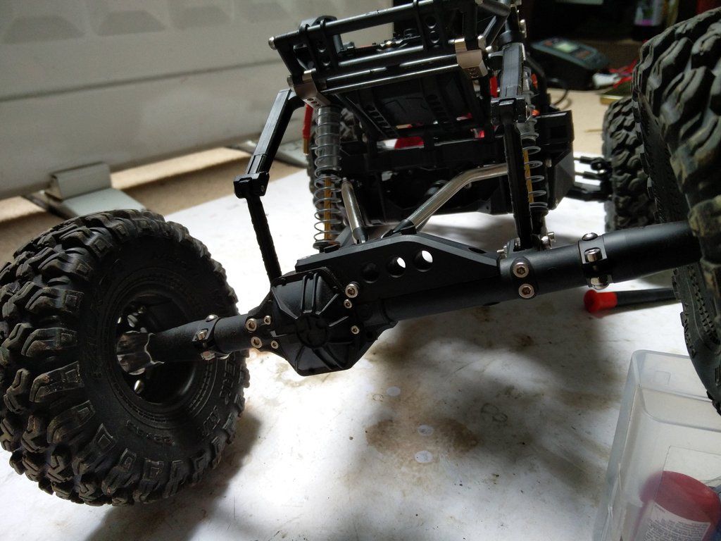

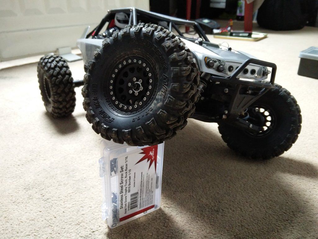

Stainless axle tubes fitted, but due to having to grind down the collars on my axle shafts (circled in red), there was a lot of inwards movement, so what I have had to do for now until I sort some spacers out is to use a few bearings where the arrow is pointing, to keep the axle shaft from moving inwards and fowling the lockouts. I plan to use just stainless spacers in the future.
Good idea with the bearings to limit the axle shaft movement. I cut some M2 screws and used the threaded part in the spool/locker to stop the axles moving in.

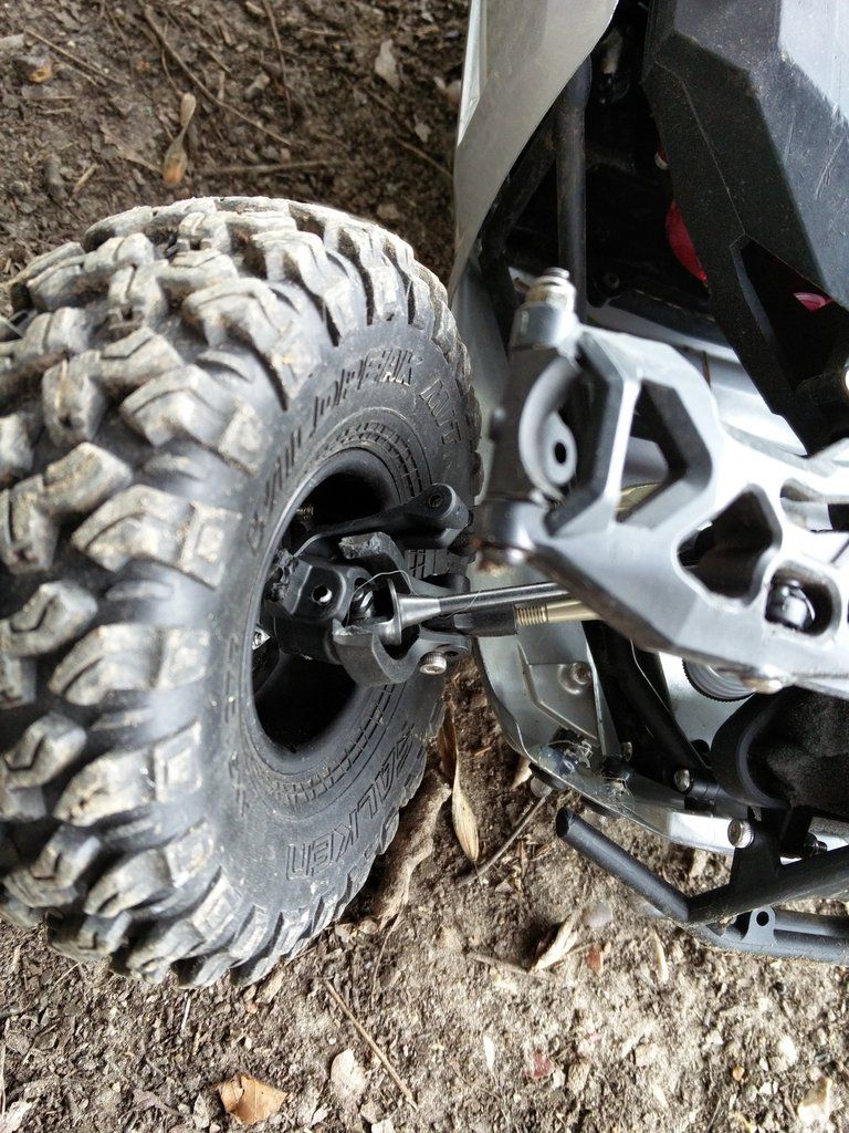

Not having much luck with the SSD trailing arms, I broke a rod end a while back, easy to replace as they give you an extra 2, then this happened today:

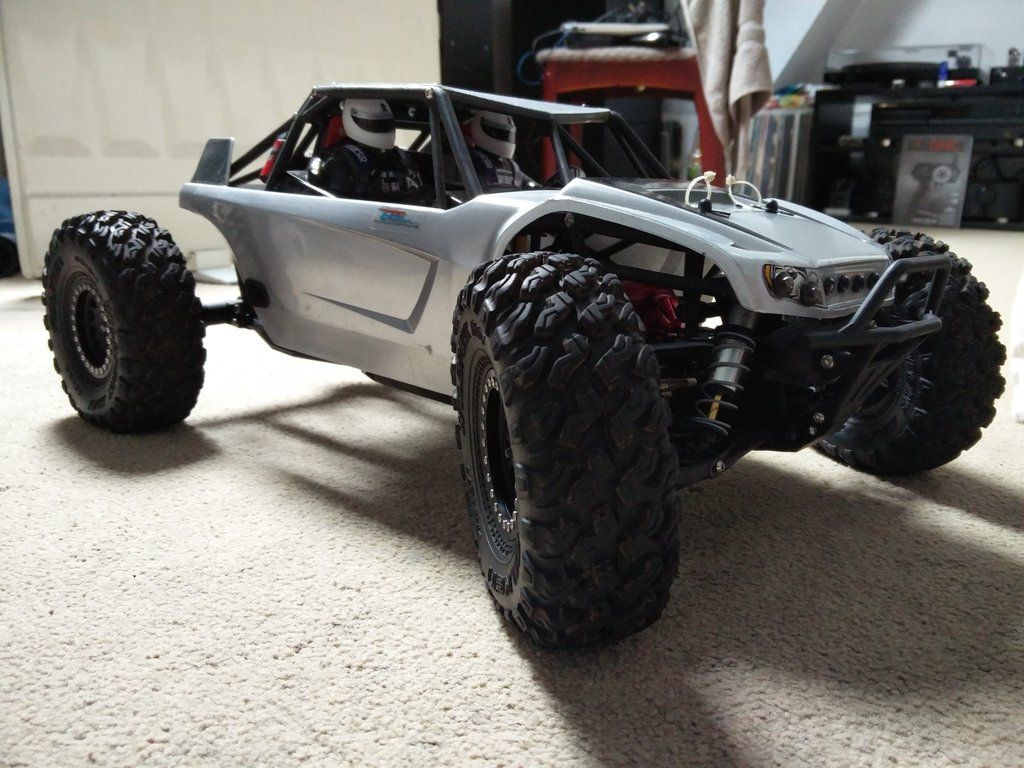

Yeti posing before it broke:
