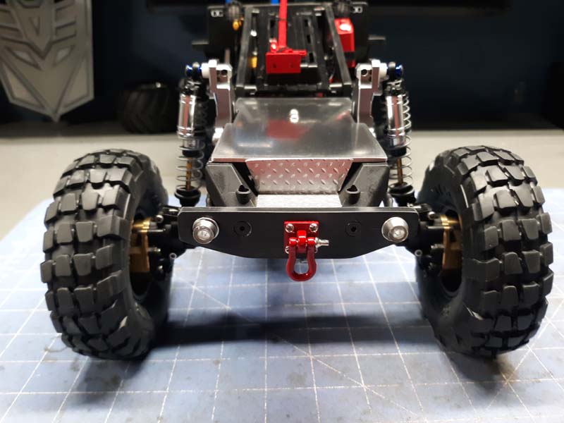

Tear down time for the 6.
Traxxas bearings are good quality, but they have a ton of drag... after experimenting with removing the seals on one of my other TRX's (and having great results) I was debating doing the same to the 6. I chew through a 4000mah pack in the same time my buddies go through a 2000mah pack... it's heavy, but not that heavy, so I figured the bearings were causing a lot of drag - especially with that second axle back there.
Before committing to a few hours of very tedious work I pulled the motor, and sure enough the spur turned very hard. I put my 3v test pack on the motor and it would barely turn the axles in high gear.
So, that means tearing down all the driveline components and removing the bearing seals. A very, very tedious and time consuming job...but, frankly, one of the best free mods you can made to the TRX platform. As I did before, I left the bearing seals intact on any outward facing parts and only removed the inner bearing seals.
Starting with the front axle...Tear it down, I give the bearings a good blast with degreaser spray, soak in some WD40 for a while, blow dry and lube with some bearing oil. It frees them up a ton. Also blast the gears to remove all the extra grease, clean out the housings and re-grease with a thin coat of red and tacky. All the driveline components looked great - no visible wear on any of the gears. Plenty of miles left!
and done... I added an aluminum diff cover up front since I had it in my stash, but otherwise just disassembled everything and reassembled as stock. You can feel a significant difference in just the axle alone.
