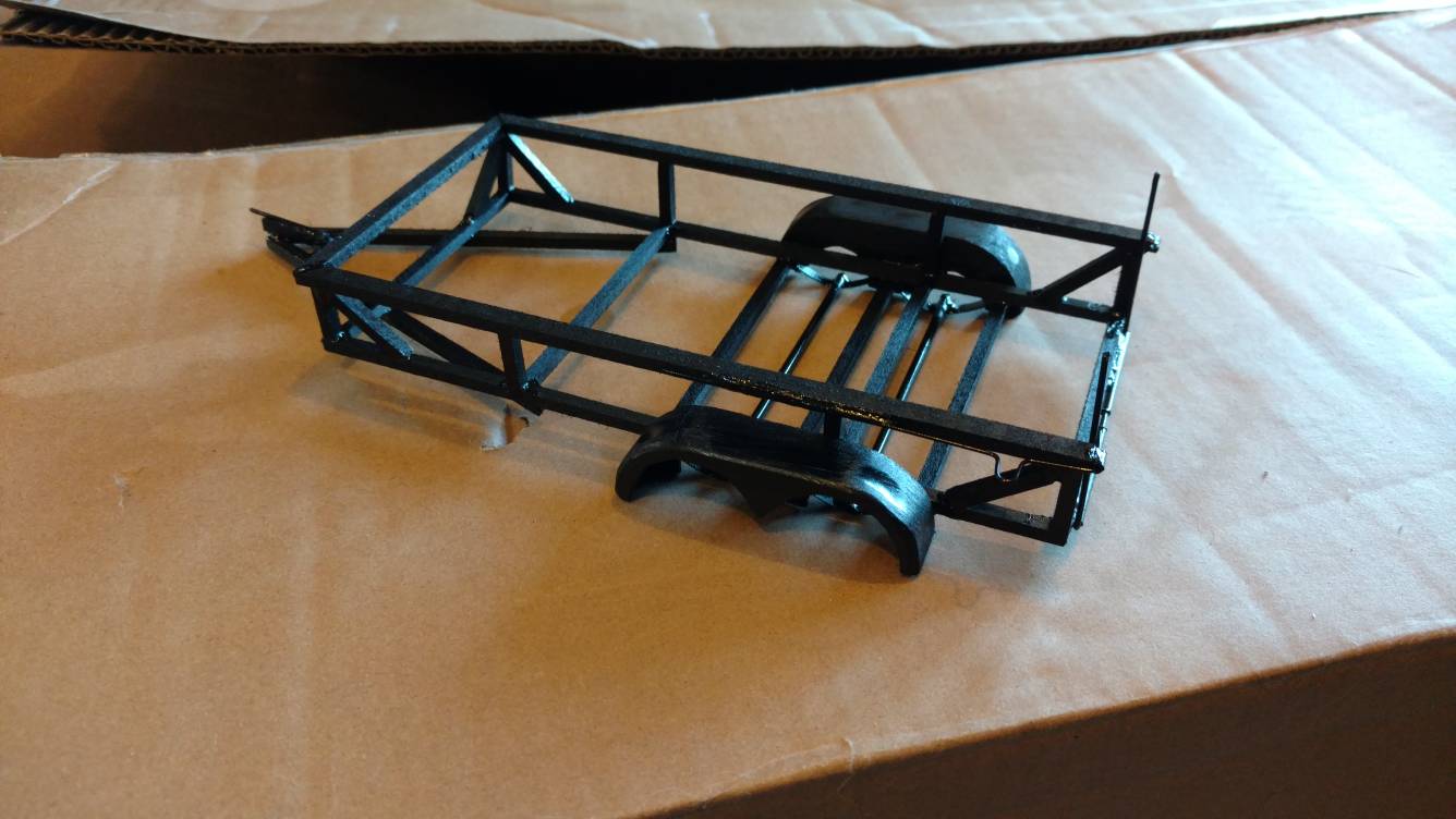

My 6yo son wanted to have a car carrier trailer... So we made one from scratch together. I decided to do it out of bass wood and CA glue as a quick prototype. In the future I might make it out of brass and solder.
Day 1:
Making the frame
Making the leaf springs
Installing axle housing
Sent from my XT1585 using Tapatalk
Car carrier trailer build
Day 2
Making the fenders out of .060 polystyrene
Car carrier trailer build for 1/35 or 1/32 orlandoo.
Day 3
Install fenders
Make walls
Hinge and lock for tailgate
Paint base coat black
Orlandoo 1/32 scale car carrier trailer build
Day 4:
Install and paint tailgate
Install wheels (harvested from a toy) and axles
Install floor (my 6yo wanted to paint tire tracks on it [emoji4])
