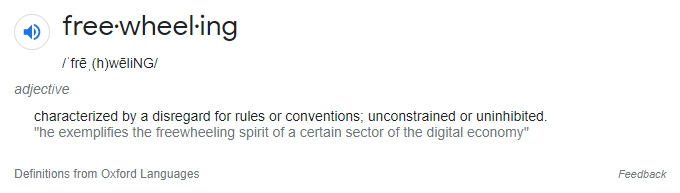

Finally a concise explanation for this. I always wondered what it actually did but never turned it off to try to figure it out.
You'd think though with a name like "freewheeling" you'd disable, not enable it for the effect it actually does. Or call it freewheel braking or something.
Probably an issue with translation, many instruction manuals haven't had adequate proof-reading, coming from overseas companies... ;-)
Maybe its on purpose...
But generally Freewheeling is considered the opposite of regenerative braking, which is what this option should be called.
