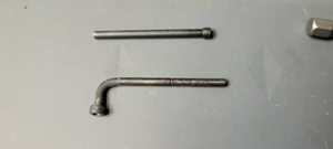

My finger tips got tired of the small bolts after a while. So I made a new "wrench" out of al Iong m3 bolt. I can ever screw on a "cheater bar" onto the end.

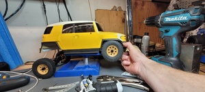

Droop and full compression with the body balancing/dangling on some 123 blocks.
Im thinking of either the newer TRD colors, or that burnt orange color. Body still needs some work on the hood. I already have reinforced the body with some cut up styrene.

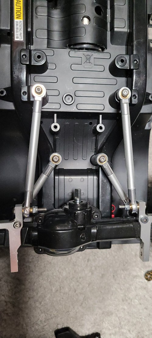

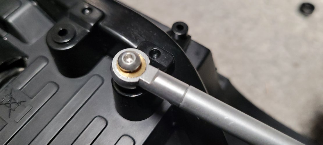

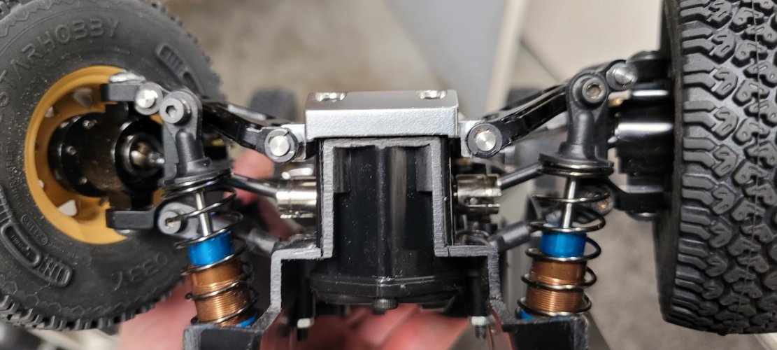

Did a little bit of work, testing out how the parts fit i ordered off of Aliexpress. Links wont be staying, at least not the rod ends. The ends are really tight right now, but will develop slop being metal on metal "brass"? I think i may modify or make new brackets for the link mounts on the chassis, so the bolts go into all the links horizontally.17164526725296339266254528992426.jpg17164526990369009133351264008033.jpg

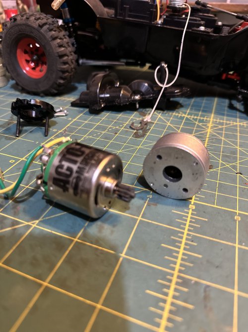

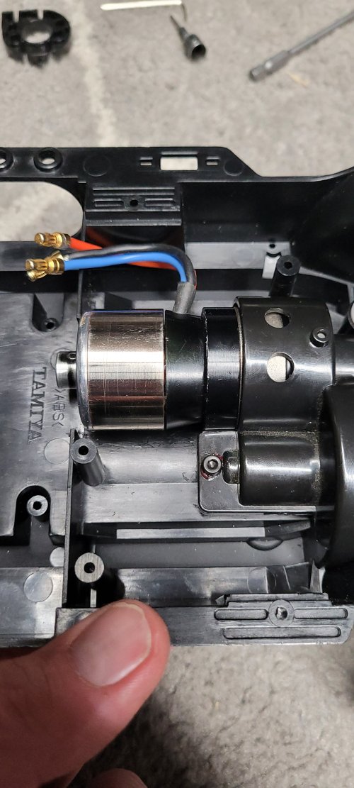

Fitted the aluminum No¹ motor mount "hidden" to a 3:1 reduction unit, that is fed by an first gen Holmes revolver from back in the 2000's.17164528536843025625218944252632.jpgUnsure of kv numbers on the motor, but I'll run it on 3s most likely.
I was shy of space, and some of the chassis got in the way.17164528320313400199326410379153.jpg

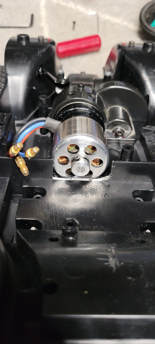

Out came the dremmel and after a bit of "zip zip" sounds it looked like this.17164528071747653362801472769235.jpg

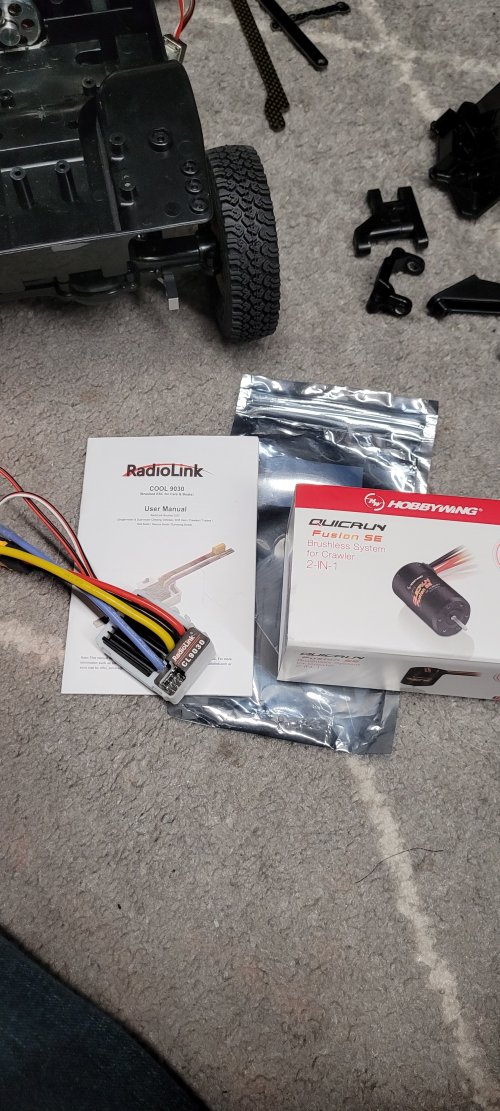

The HW 16bl30 ESC i got for this should handle this little piggie, i hope, otherwise ill try that 90a radiolink esc (can run on 4s) with something brushed (how many turns a motor should i get?) or the 1200kv 2 in 1 fusion system no gru? Anyone have any experience with either of these?

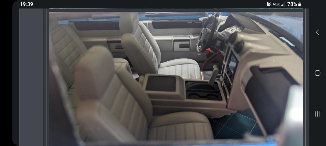

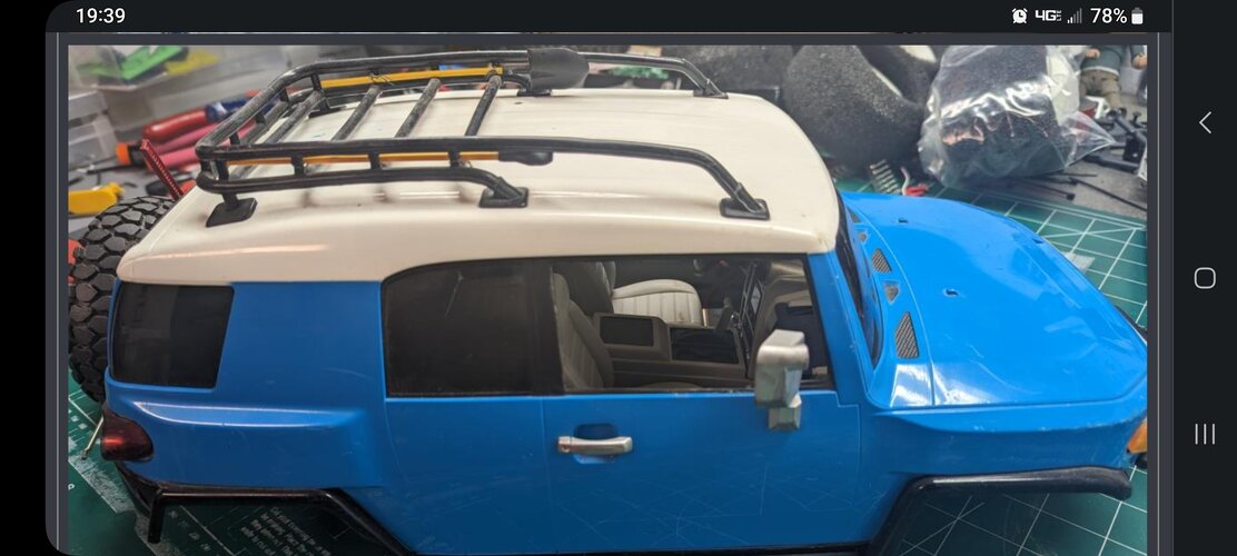

So a few days ago or so I stumbled upon this image of an interior inside the body. I wonderScreenshot_20230804_193918_Chrome (1).jpg
Would the interior fit over the cc-01 chassis?Screenshot_20230804_193934_Chrome (1).jpg
Now the search for that begins.
Looks like a good fit, whatever that interior is. It's not a FJ interior though if that matters to you.

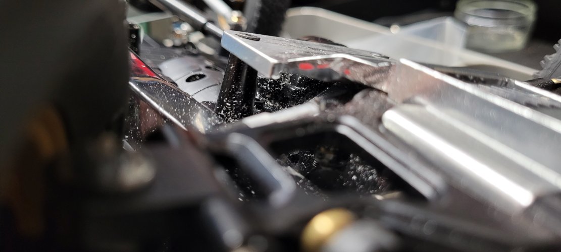

I figured out the notchy-ness, it comes from the steering tierods binding up against the alloy skid. Needs "machining" with a dremmel in the area that's marked red on both sides. 20241110_203625.jpg
When there's some weight in the rig pushing the suspension arms up, or down, depending on testing orientation, the steering action works fine. Shocks are a bit too long i guess, about 5mm.20241110_203712.jpg so at full droop it will still have the driveshaft oscillation from the dogbone.

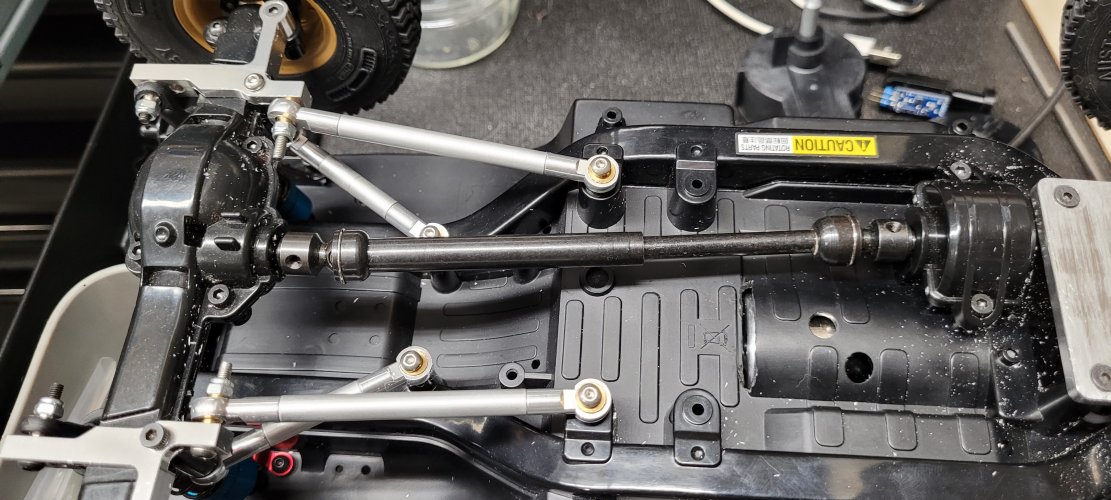

The CC01 drive shafts come in two sizes. One for the shorter wheelbase trucks such as the Pajero, Jeep, Mu etc and and longer driveshaft for the longer wheelbase CRV, Touareg and FJ Cruiser etc. if you can find the stock Tamiya longer shaft you’ll be set. I like to make my own indestructible drive shaft using two Jato half shafts.
Worked on the skid plate a bit and took off what I thought was necessary. 20241112_105242.jpg
